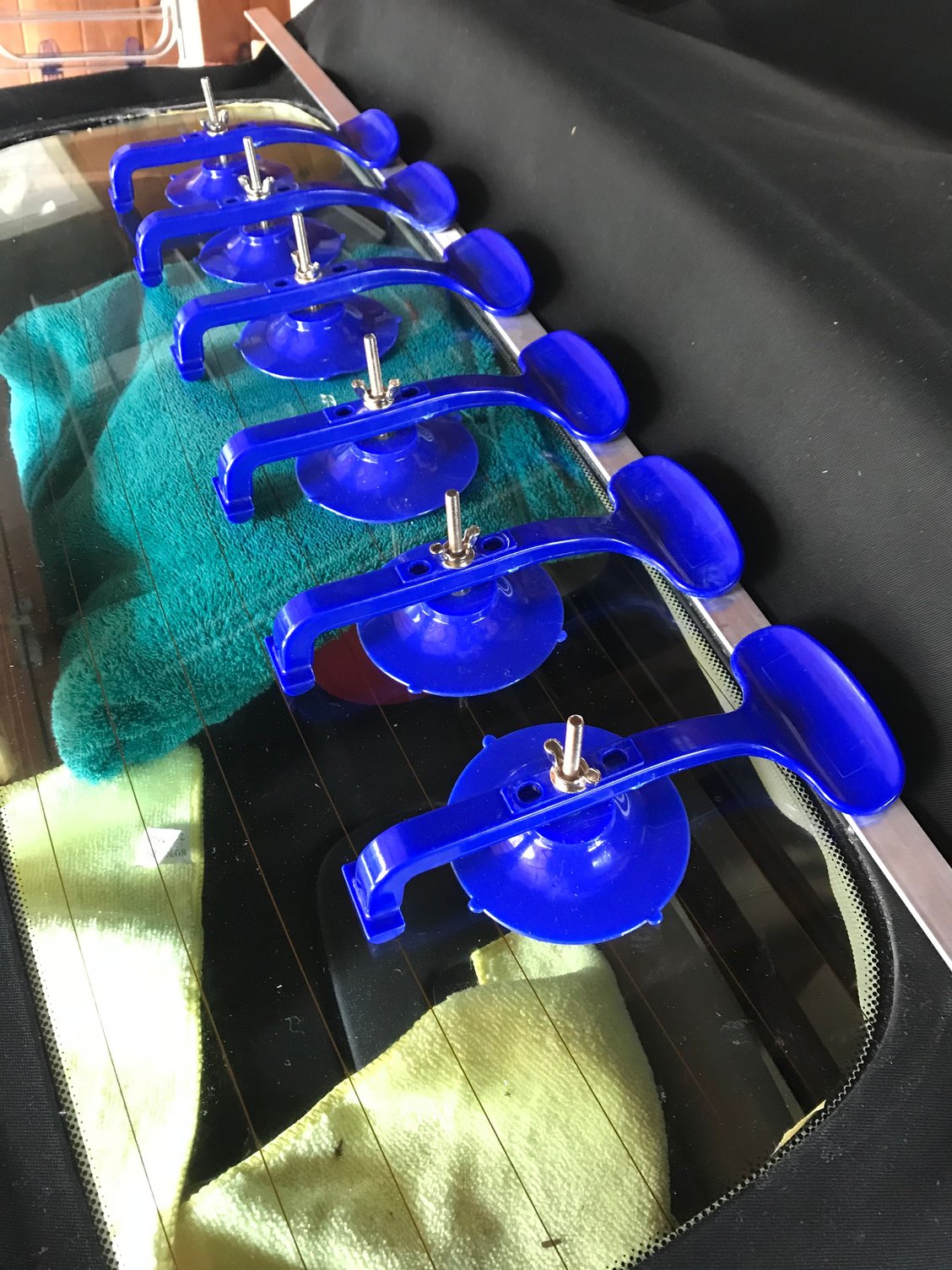

Rhino Glue dries fast, but you still need the Suck N Clamps to provide uniform pressure for 60 seconds along the length of the repair. I used one paint stirrer stick at a time between the clamps and the top, and tightened the clamps down just enough to be snug. Follow the instructions on the label.
From Amazon:
https://www.amazon.com/dp/B07YF6WZ9F/ref=cm_sw_r_cp_apa_fabc_jGZSFbZT8YWVA?_encoding=UTF8&psc=1 https://www.amazon.com/dp/B07YF6WZ9F/ref=cm_sw_r_cp_apa_fabc_jGZSFbZT8YWVA?_encoding=UTF8&psc=1
