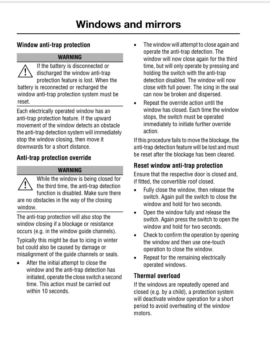

Were the windows reset after you had the new battery installed? If not, that's probably the cause of your problem.
First thing to try is to reset the windows. Do this on both sides with the ignition ON.
  1. Raise the driver's window up to the top seal and release the switch.
  2. Raise it again until the window stops moving, and release.
  3. Pull the raise button again and hold it for 2 seconds.
  4. Lower the window fully and release the switch.
  5. Press the lower button again for 2 more seconds until you hear the relay click.
Do the same thing on the passenger side.
Hopefully, that'll work. From the Owner's Handbook:

I think I fixed it. I kept trying the reset procedure but could not get the 'click' when holding the switch in the up position.
I tried repeatedly commanding the window up and after several micro - movements towards up and closed, I did get the reset click. It appears to be working correctly now.

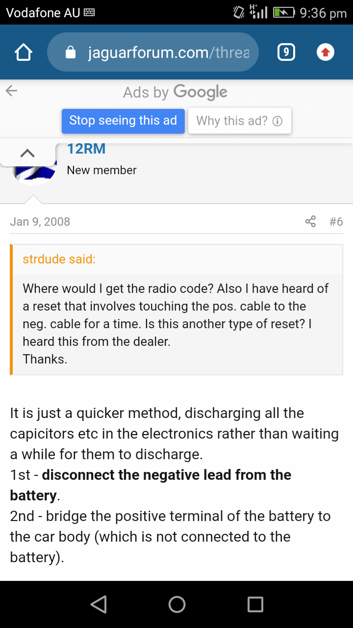

I've had this happen a few times whilst having the window down and my.battery disconnected , a Hard reset does the trick
What's a hard reset vs a reset, and when is what needed? In general terms
Old Dec 31, 2020 | 04:38 AM
steve_k_xk's Avatar
Joined: Jun 2015
Posts: 3,005
Likes: 1,675
From: Sydney, Australia
Hard reset is usually used to reset any electrical gremlins however it will not reset any stored DTC codes (some ppl also use it to reset the tcm , allowing the vehicle to readjust to their new driving style)
https://www.jaguarforum.com/threads/hard-reset.9019/
Post #6
Ceejay or Stuart are big fans of this particular method , I forget which one it is however I'm sure one of them will chime in on my behalf 👍

A hard reset is the "nuclear option" and should be a last resort rather than being seen as the panacea for all electrical/electronic gremlins. The main disadvantage is it clears learned adaptions such as fuel trims and resets these to default values. There may well be times when you would deliberately want to do this but lost window travel limits is not one of them.
