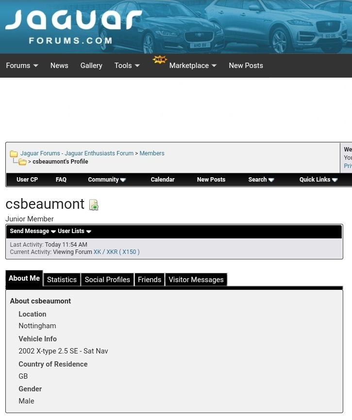

Do you have a 5.0L X150 (XK/XKR)? Is your Personal Profile correct?

I'd totally forgotten about that, that's my old car. The XK is 4.2 non-supercharged.

Please add VEHICLE DETAILS to your forum SIGNATURE.
Model Year is important when asking for advice on the X150 as there are many differences between the early 4.2 and later 5.0 vehicles and between individaul years of these variants.
