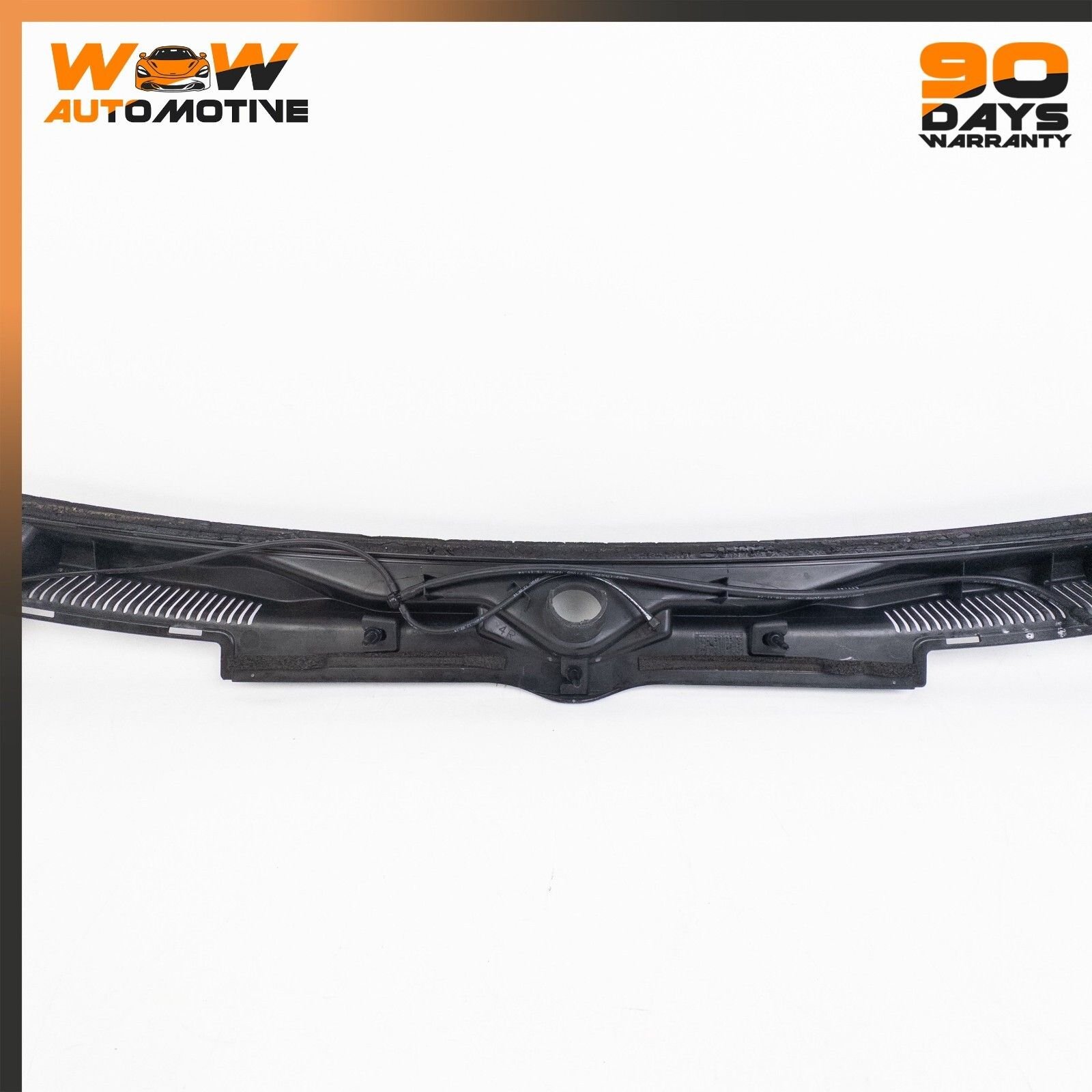

They are tricky to release but they are all pull straight up clips. I recommend getting a plastic trim tool in there to help. Here's a pic of the underside so you can see all three clips.

Thanks so much, a picture is worth a thousand words !! I can see the middle one but not the other two.
Nothing at either end ? It sure feels like it is secured

As I recall, nope. It's usually just well seated. Be gentle and lift with firm pressure and you should be fine.
