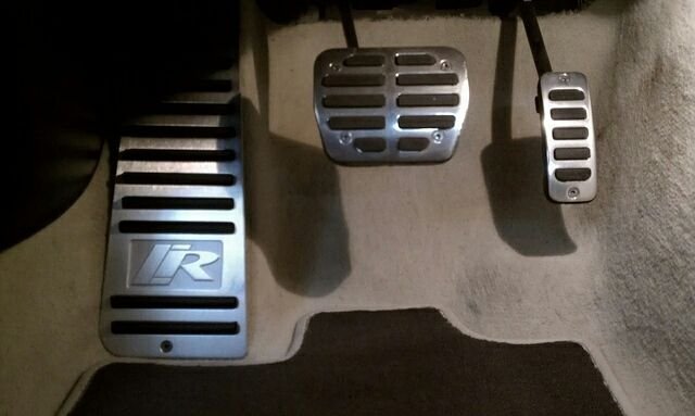

Off-topic question to Kubaa: In the picture in post #10, those are nice looking pedal covers. Where did you get them?

Hey, those came with the car. A quick Google lens search reveals those may be available at AliExpress. Hope that helps!

I have them on my 2013 XJ:
My 2009 XKR Portfolio Convertible came from the factory with pedal covers. I added the custom //R logo footrest.
