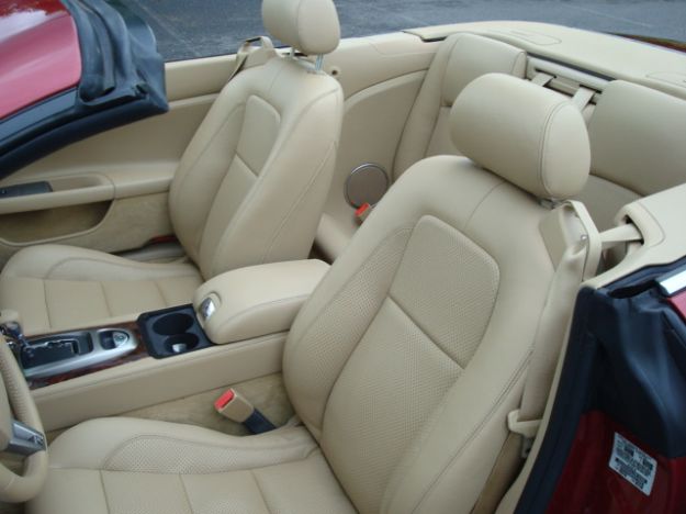

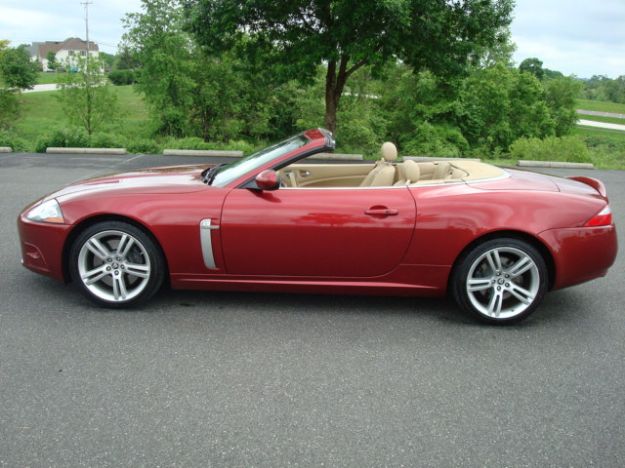

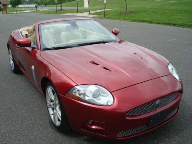

Default My (wife's) 2007 XKR
Some pics of an admired car.

Ah, the red over caramel is awesome!

congrats on the new car, great example you found! That red is beautiful. Enjoy, and keep an eye on that speedo
