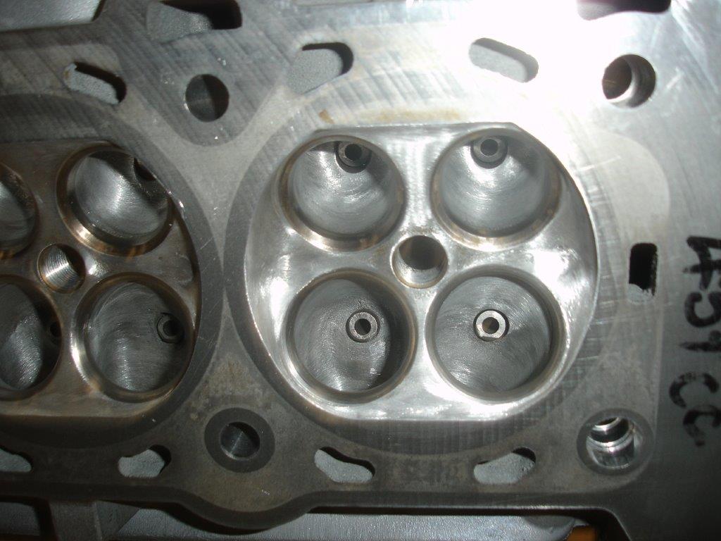

The GT3 4.2 heads:

The GT3 4.2 heads:
XJR,
What are the specs on the valves? Are they the same as stock? Have you documented any flow numbers on this set?
Any way you could mic the valve head diameters? Or port dimensions? I'm curious what was opted for performance. I'm looking into located a spare set of heads to build myself.

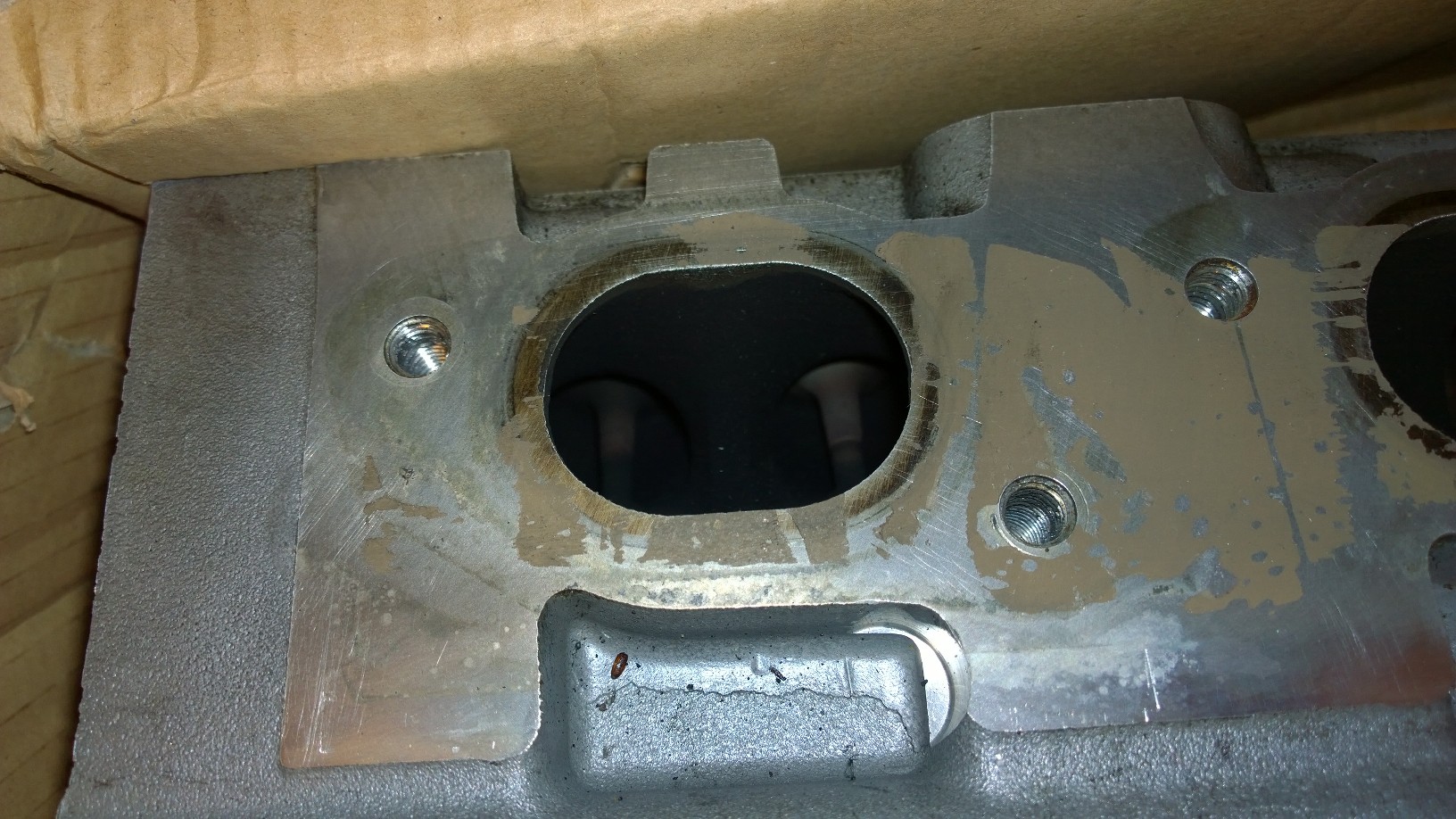

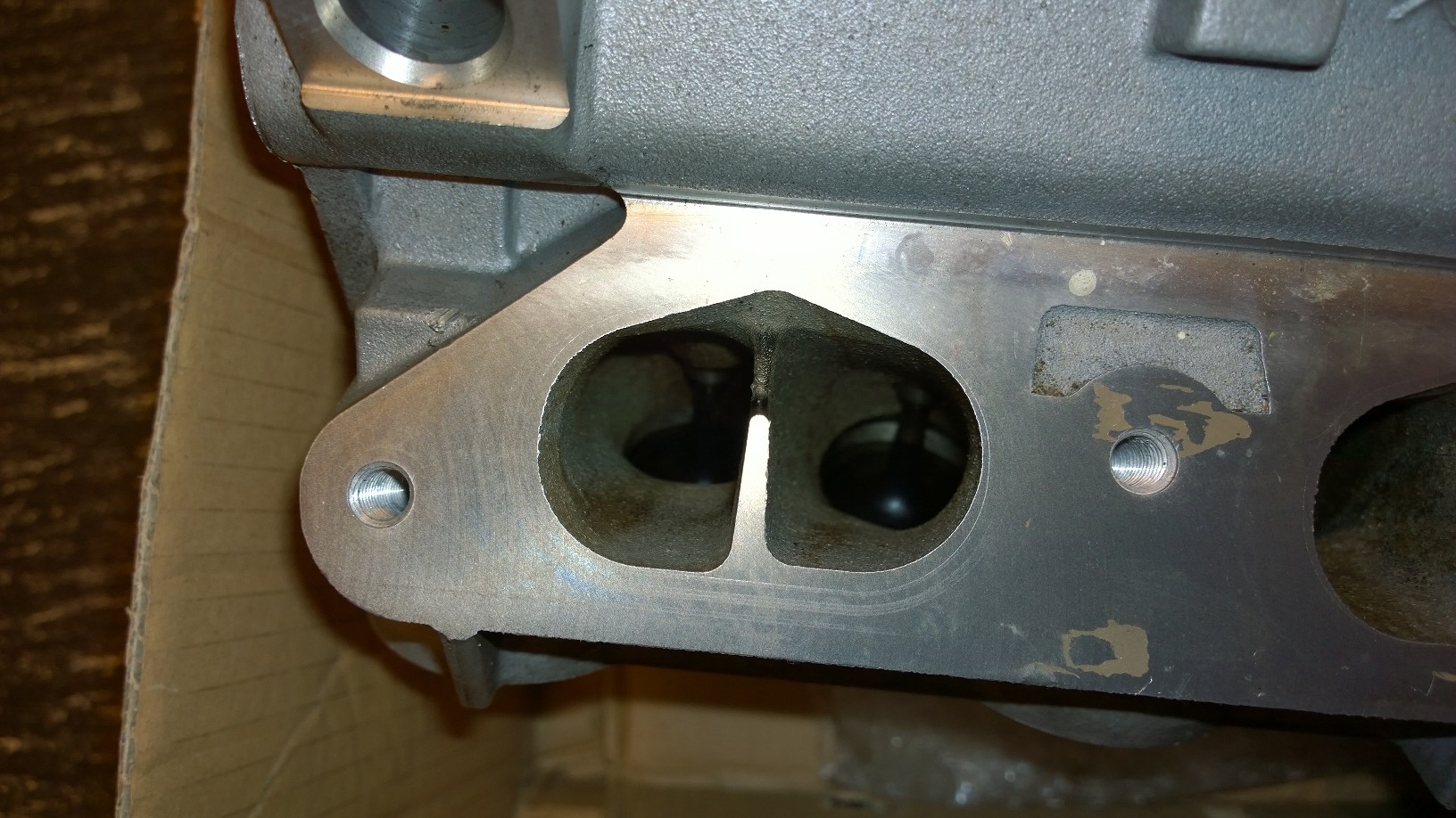

The valves are stock ones. I have not flow tested them myself. Stock AJ133 heads: 0.6 at 0.3 L/D which is about 0.17 Alpha K ( said by forum member Count Iblis ) They do not look overported but should flow enough for the GT3 engine. Here pictures of intake and exhaust ports.

Here real GT3 heads with all portings and combustion chamber modifications made for FIA GT3 standards. Please ignore pictures above.
