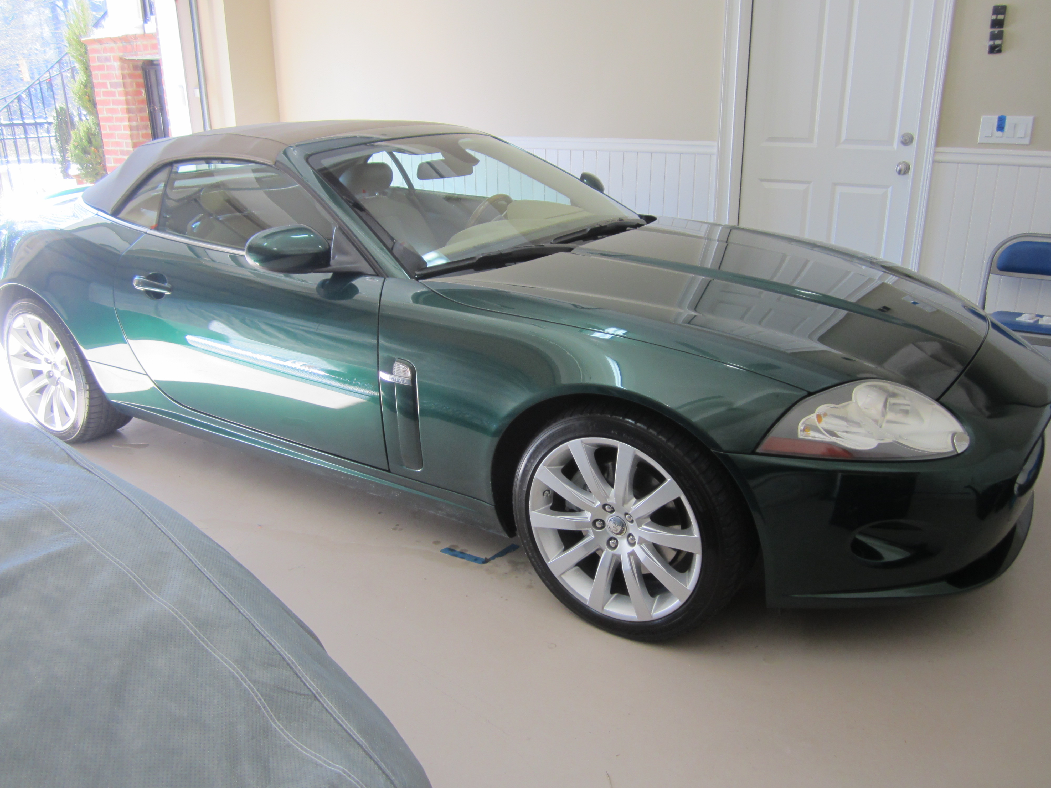

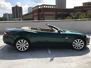

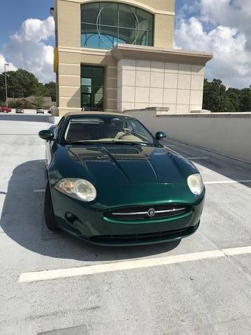

Thanks! Pics of the car.

Beautiful car BTW...congrats!

Good looking ride. Enjoy it. Regarding the battery; it needs to read 12.5+ at rest. Also invest in CTek battery minder if you have electrical power near where you are going keep the cat when not driving it. The Ctek and necessary accessories are available on EBay or Amazon for less then $100 all in and it only takes about 15-20 minutes to install it. Then between 15 and 30 seconds to hook it up or unhook it. A real sound investment.
