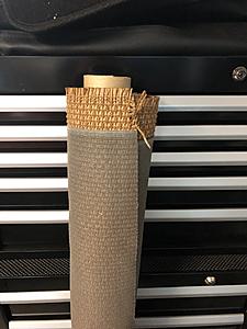

Thank you for your responses. We have located a frame, but her dark blue top is not that common , plus it is in really good shape. I was hoping to get that frame and just swap out the broken member. Either way, it looks like I need to pick up the frame while I can. Does anyone know what material they frame is made of? The break is easily accessible and was thinking it could be carefully tack welded?
See the attached photo of the snapped frame member.

Now that's just plain strange, what ya got to lose, find a good welder and give it a try.

Yeah I feel like there is a story behind how this happened that I am still waiting for.
This doesn't look like a failure within normal operation.
Just a guess, maybe an attempt to close while the cover was over it?

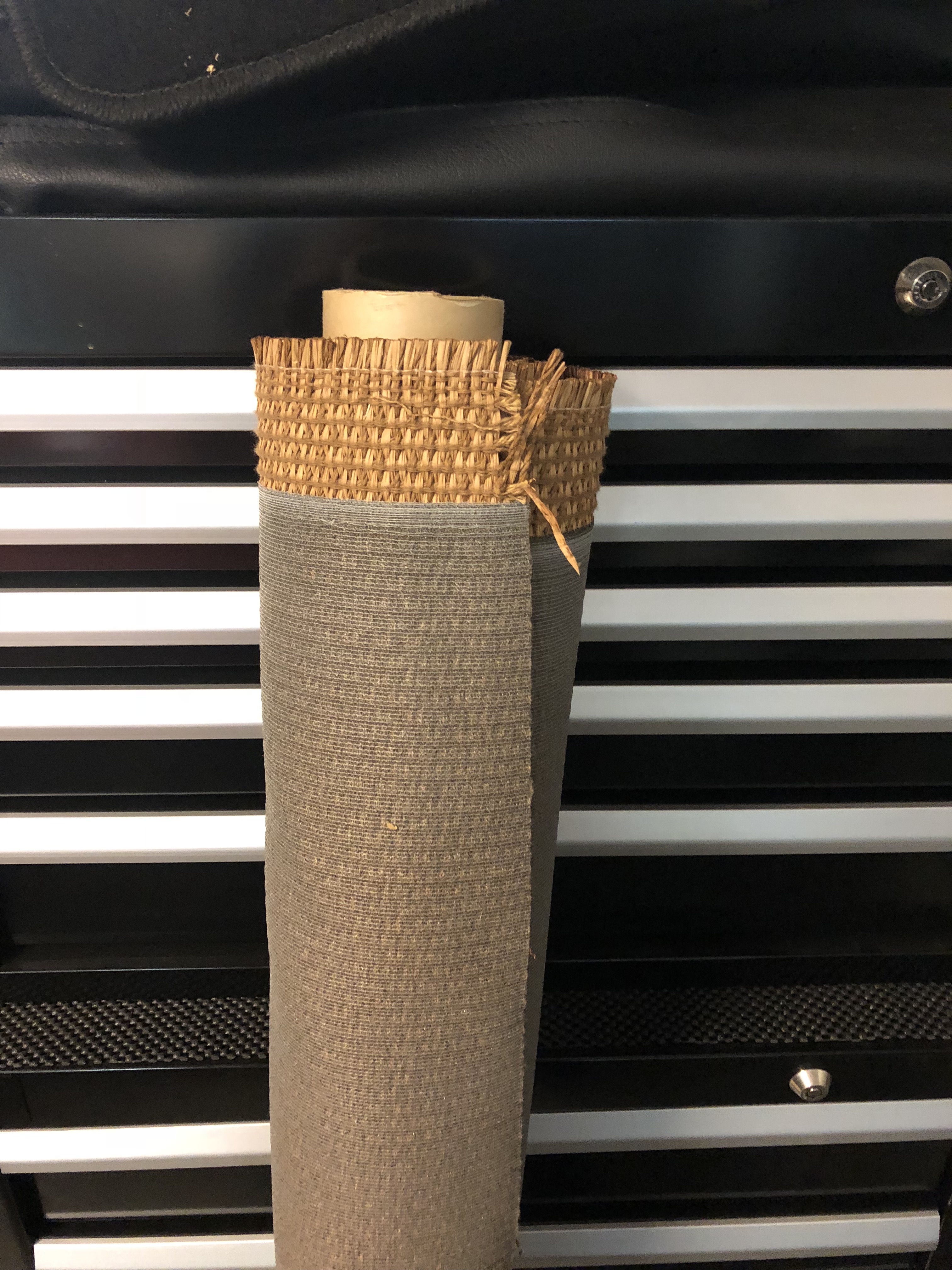

I just saw that I had "roller fabric" in the original post. It should have been "roll of fabric"See the attached photo of a smaller version of what she was hauling around. The weird thing is that when the top hit the resistance of the fabric roll, it did not stop. Maybe, it does not have that feature. Nevertheless, that is the "story". There was definitely a cause for the breakage.
Our local upholstery guru says he can make the repair if we find a replacement frame member. Working to source the part now.
