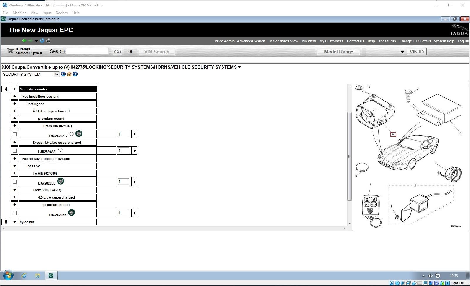

I don't have the sounder anymore, thought I had taken a picture of the label but can't find it. Is there a way of finding out what the correct sounder should be?

..... Is there a way of finding out what the correct sounder should be? .....
Here's the Security Sounder part numbers which are dependent on VIN and specification.
No longer available from JLR but were around 95 UKP.
