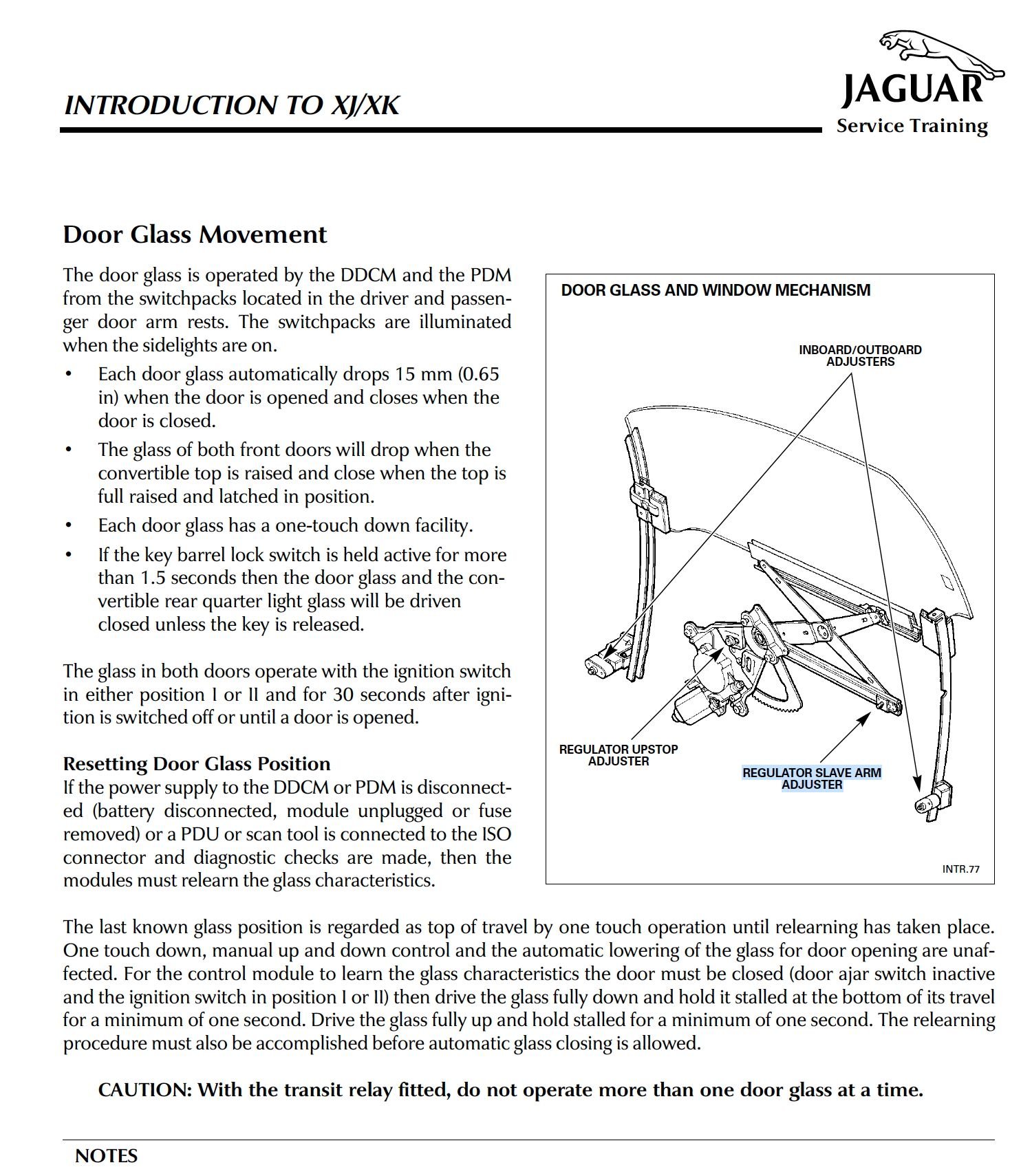

I’ve watched several (all) videos and read threads about XK window adjustment. I understand the inboard/outboard adjusters control how the window sits relative to the frame, and the up-stop controls the maximum height. But my problem is that the window no longer rises level — the front lifts lower than the rear, creating that visible gap at the back.
The workshop manual mentions a “regulator slave arm adjuster”, but I’m not sure if that’s relevant or how to use it. It’s possible I may have shifted the glass forward or backward in the carrier while working on it.

Not found anything on this adjustment so wondering if it might be relevant - Regulator Slave Arm Adjuster

Having taken the door card off as well as the water shedder I then used a lot of silicone spray on the two vertical guides, I then added some Lithium Multi-Purpose Grease. The window at least travelled with ease now.
Of all the window adjusters the one that was key was the nut in the middle "back" of the door (The regulator slave arm adjuster). Thanks to ScotAmb who sent me details on this adjuster, and also see this post here https://www.jaguarforum.com/threads/...on-xk8.110852/ - It is amazing how a tiny adjustment of this nut makes the glass seal well and aligns with the door pillar seal (no more getting wet at the jet wash!)

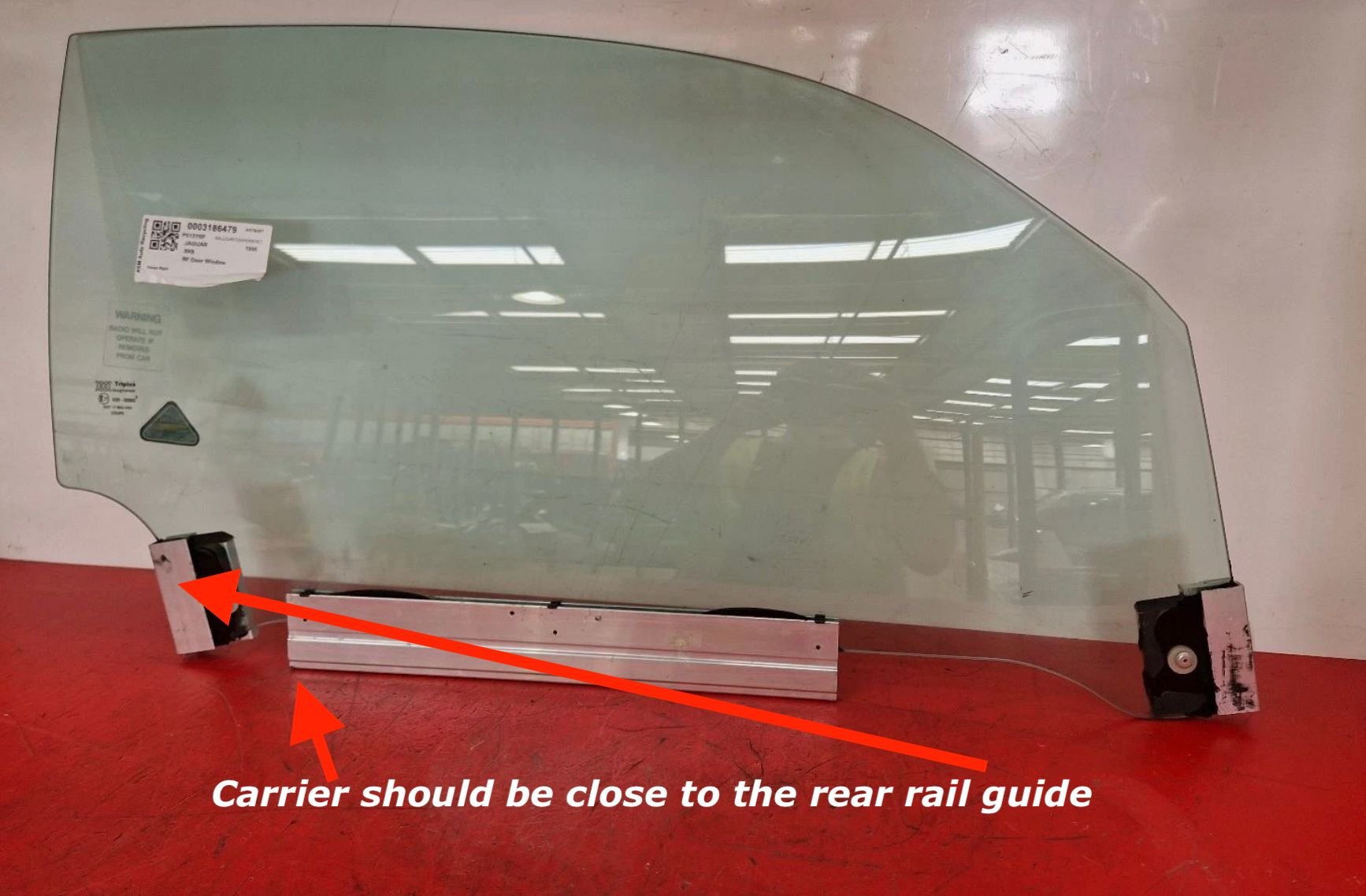

Probably my main issue though was the glass had moved along in the metal carrier as seen in this marked-up picture (glass from ebay) - I heaved the glass upward so it came out of the carrier and then moved it well along close to the rear pillar and that got my window working well but not aligned.
