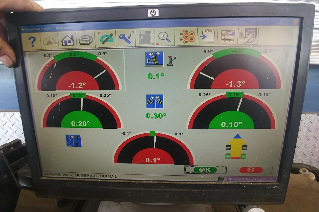

So many of our threads die a natural death without notice of any resolution; thought I'd share an update on my loose steering issue just in case anyone was curious, and also to create an informal poll to get everyone's vote. Since I had purchased a 5 year, no-limit alignment policy from Pep Boys after getting the cat home to Las Vegas from Boise last year, I thought would just get them to check for any other concerns while waiting on the inner and outer tie rods I had ordered to come in. Turns out, I should have just gone there first.
Seems the front tie rods are fine; the cause of the wallow actually comes from the opposite end of the car. The alignment tech at Pep Boys has been around for a while, and knows Jaguars. As soon as he saw the excessively-negative camber reading on the computer monitor, he immediately inspected the rear shock (upper) bushings and confirmed that they were deteriorated and collapsed. This, he said, would account for both the excessive negative camber and the loose feeling in the sweeping turns. We discussed the possibility of a need for new shims for the rear end, but he advocated waiting until he could check alignment after I replaced the shocks since Pep Boys pays him by the hour and not by the job. I like this guy... So, I have new Bilstein shocks and bushings ordered (Pep Boys does not offer these parts) and will install them then get a new alignment asap.
Here's the subject of my poll: Do I keep both sets of new inner and outer tie rods for some future need, or do I put them up for sale? They're not outrageously expensive, but, what are the odds I'll ever really need them? Also, anything else I should go ahead and replace as preventative maintenance while I've got the rear suspension pulled apart? My differential is leaking a tiny little bit and will have to be addressed at some future date; do I save a significant amount to tackle it now?
