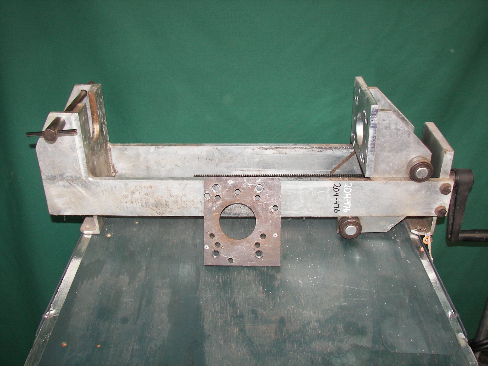

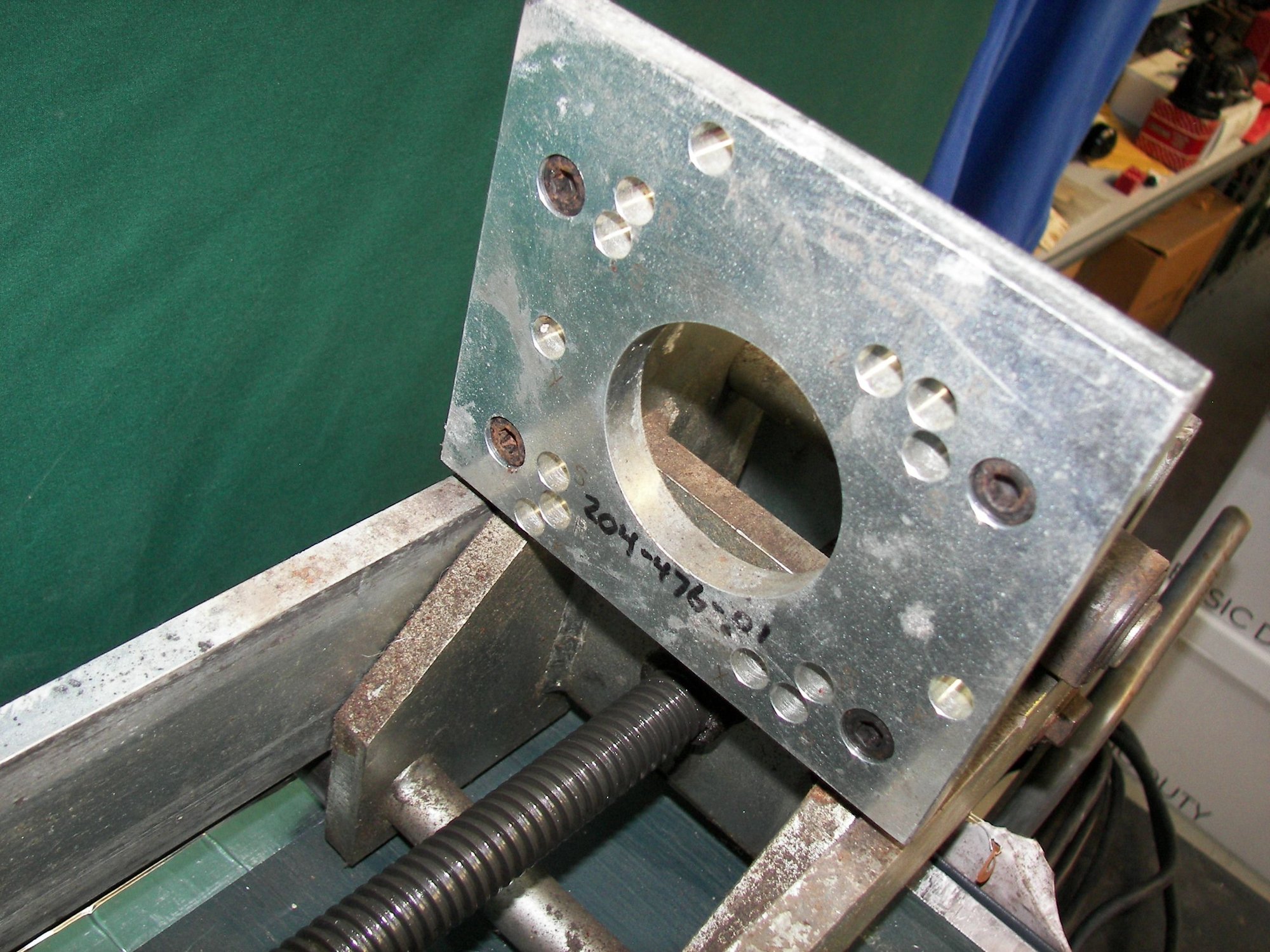

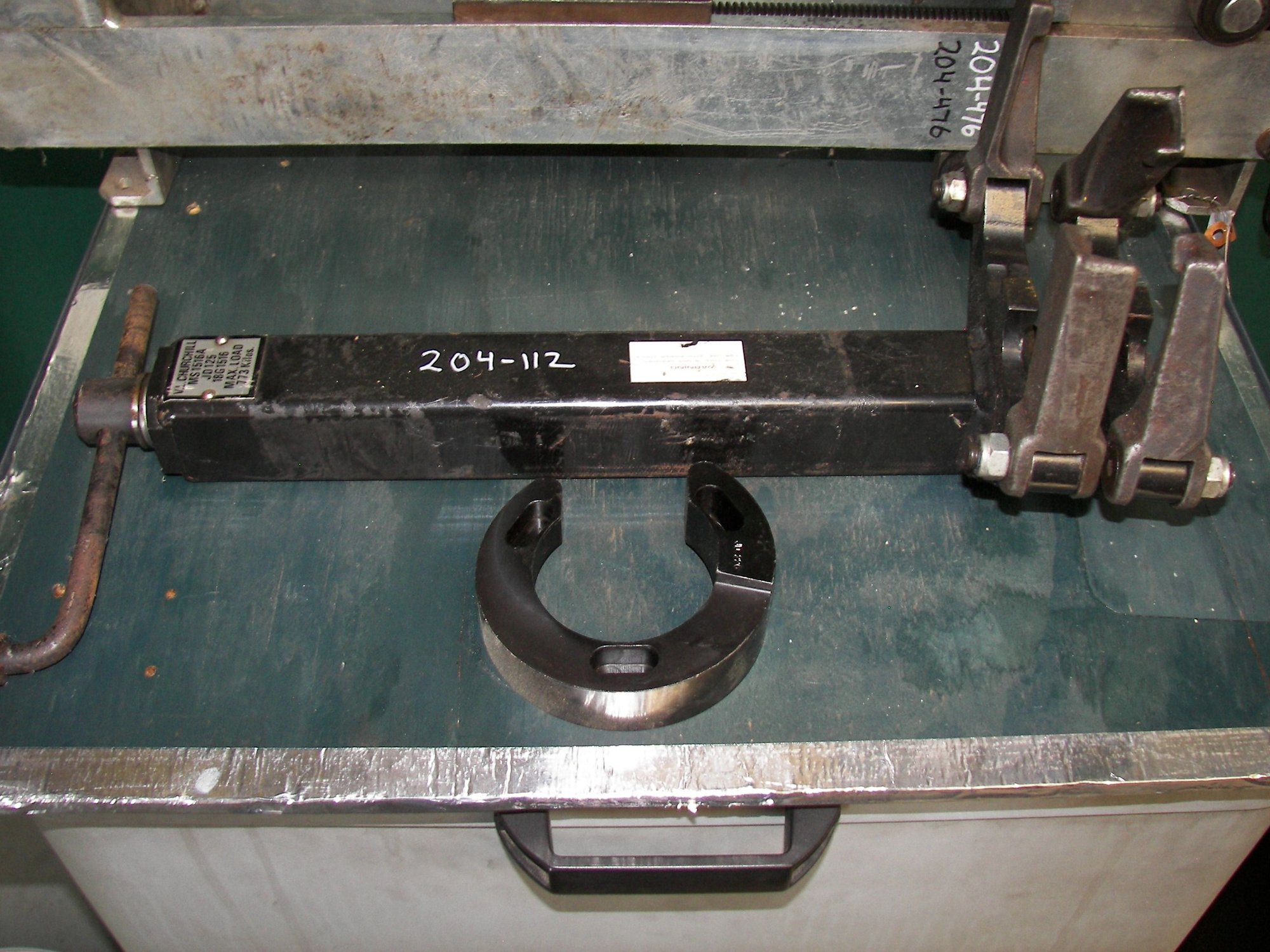

Tool 204-476 Later version for dealer techs. Early adaptor plate in front.
Later adaptor plate marked for models.
Earlier tool 204-112 with adaptor 204-112/01
John these may give you some ideas. Both are very positive (ie: safe). The larger tool is very fast and replaced the earlier tool 204-112 or JD 125. All of these would have come through Mahwah. Perhaps Rally Motors or another dealer near you will allow you to borrow one of them. BTW there is a JD125 or 204-112 on E bay now (see Churchill Tools) Best of luck and be safe!

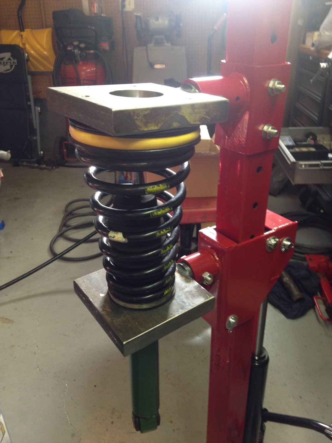

John - here is what I did the last time I had to replace -

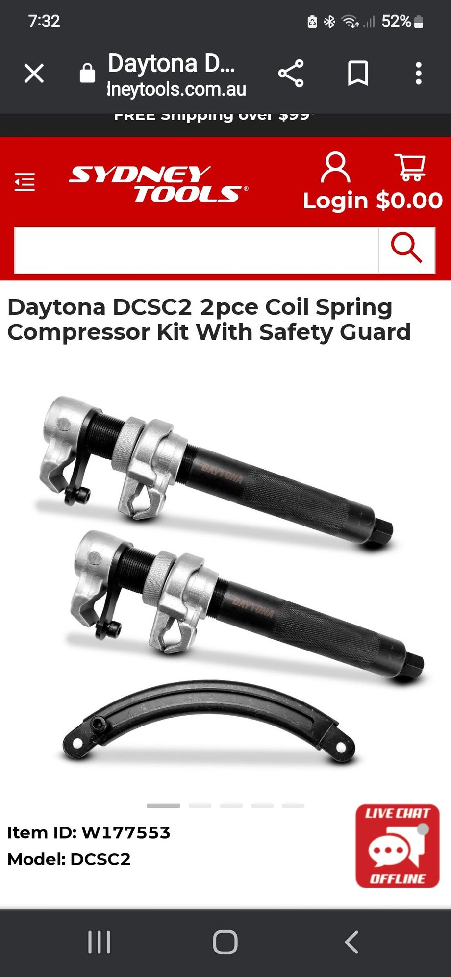

I've just replaced my shock mounts and used these compressors with great success. They are designed with more safety than the more traditional type as you can lock them to the springs to prevent any slipping..

John - I will take a pic of the plates the assembly is sitting on, but it is 2 pieces with cutouts so when placed side by side, there is an opening that I just used to insert the socket and remove the nut. Once the nut was removed, I slowly released the pressure on the press and removed the assembly so that I could put new bump stops, gaiter and new shock mount in place, then put it back into position on the press, compressed to where I could get the nut on snug, then released pressure and removed from the press

What Steve does has worked great for me in the past and I must say adding a swing type chain through the chain and around the press side with a bolt in the chain to keep it tight makes me feel a lot better.
Going under the press and pushing the shock stud into place (center of the washer) can give you a uneasy feeling, thus the chain.

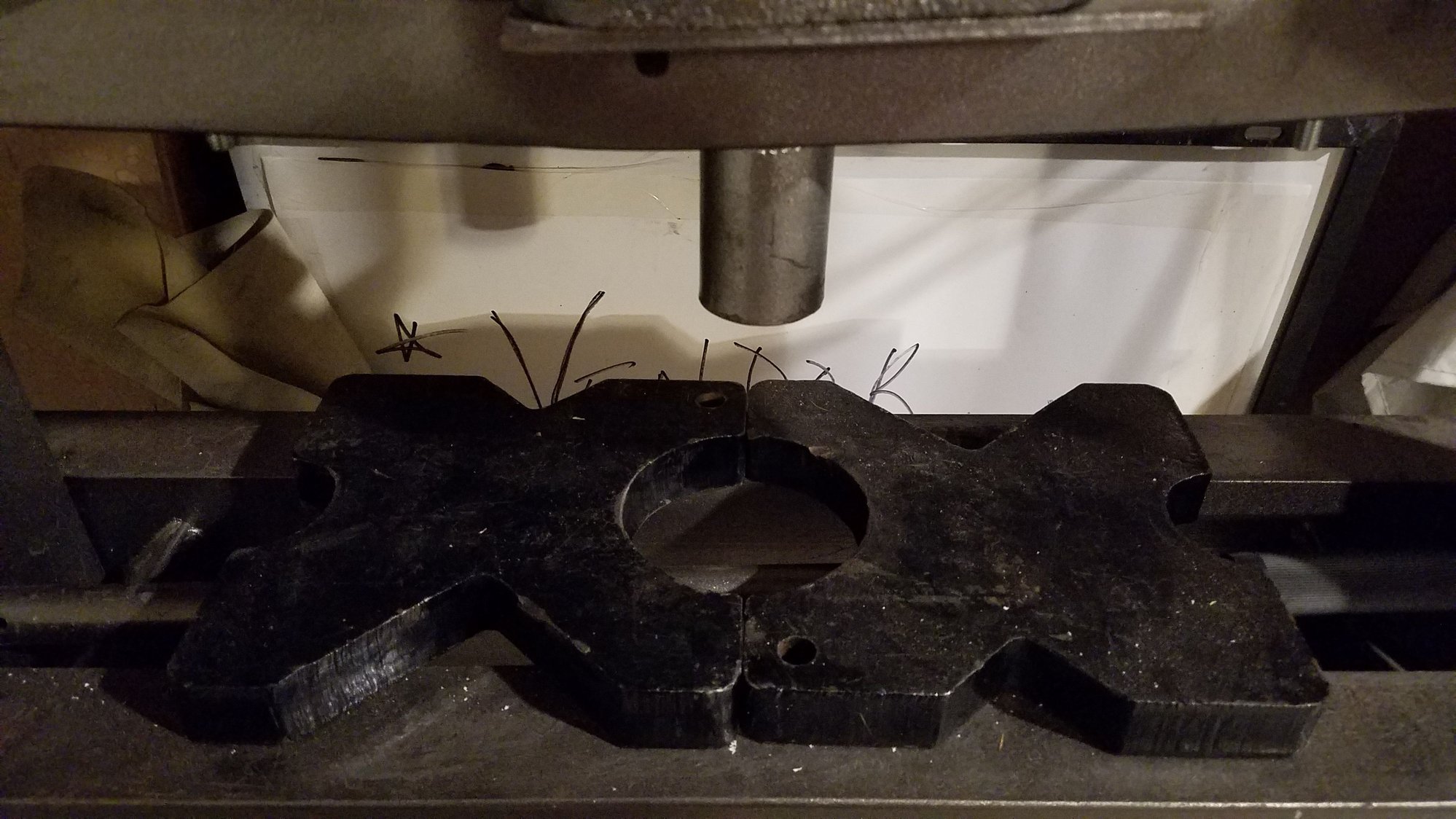

John - here is a pic of the plates

Steve, see that I can predict the future- it was obvious as hell (no excuses i own the plates too!!
Darn - no excuses left now, guess what I'm doing this afternoon?

Johnken those plates are standard fare with a small press. If you look close I think Steve has drilled out a couple of holes for the studs. Hope it works but it sure does not look safe and especially not if you have adaptive suspension and have to deal with the internal wire! Too much time upside down with that in the press. It would be our luck that when it flew off it would miss us and hit the propane tank and take out the house and us! LOL Be careful and good luck!

John the plate stand will have to be on the lowest setting to enable the release of the spring, if not enough room it will still maintain pressure on the top plate and cause a dangerous situation.
Don't forget the chain or some type of strap, it's not too difficult to get straight up and down and the holes in the plates does help kept it flat.

Yeah never said it was an OSHA certified rig but it worked. The holes in the plate were there when purchased from Harbor Freight but if you look closely at the pic of the shock assembly in the press, the 2 plates have a bit of separation between then and the studs for the assembly are in the open space - just the top plate of the upper mount is resting on the spacer plates. I felt less safe having the studs be the pressure point for the assembly than I did the top of the mount
