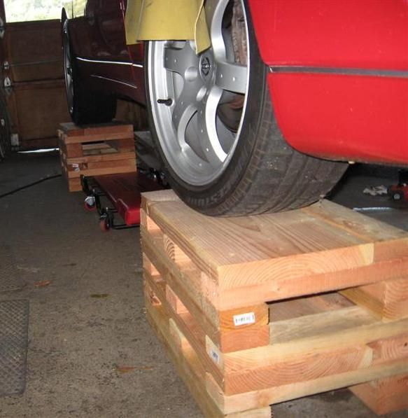

An alternative I'm thinking is that you use jacks in the front and rear central jacking points to lift the car as high as possible and set it on wooden cribbage, stacked as high as possible. With a combination of ramps, or low profile and truck jacks, you might just be able to lift the car high enough to put it on a foot or two of cribbage. This will be a slow process. This way the weight of the car will be on its four tires, instead of on any jacking points.
Something like this
If you can't safely lift the car, is it really repairable?

Originally Posted by giandanielxk8
....... Something like this
Ultimate JENGA.
On a more serious note, I've often used timber blocks to gain height for repairs. It's a low cost and safe approach.
Something like this
Thanks - great idea with the blocks
However, I did not want to use the front left jacking point as the was one of the sills being rust repaired. It looks like I should be ok to use it as I have nearly completed the outer sill repair in question. I will be able to use both fronts as normal. I will jack the car up at the rears by the rounded area / beginning of the lower control arm? Looks pretty solid to me!
