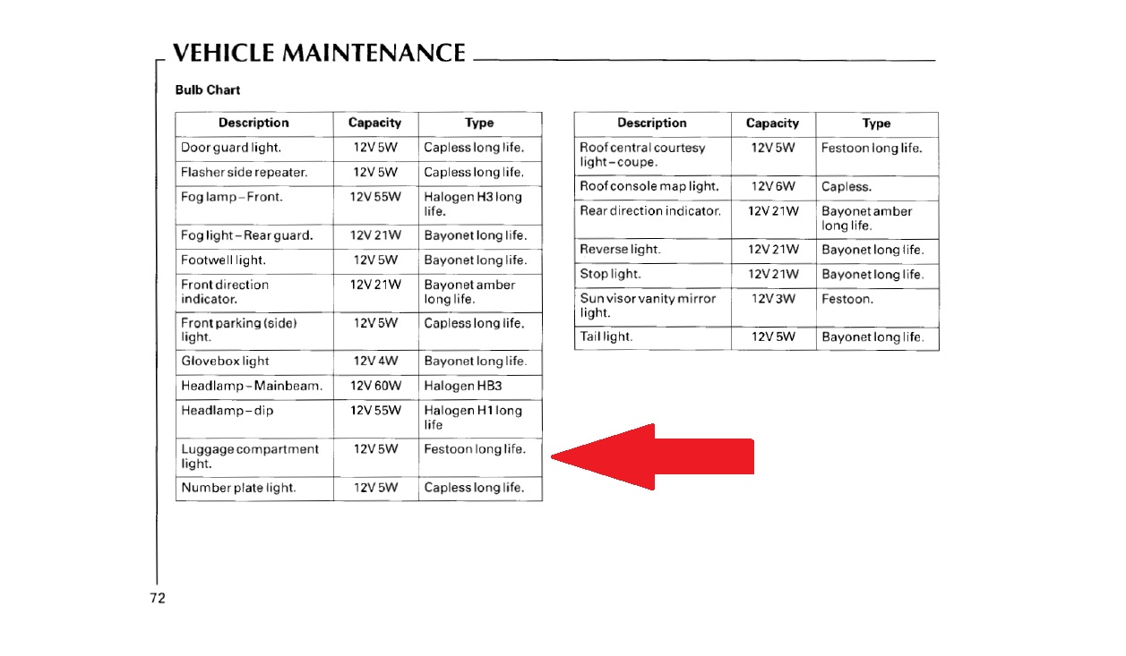

Anyone have any idea what replacement bulbs I need to get for the internal boot compartment lights for an XK8 convertible 1996?
Thanks
Old Oct 12, 2016 | 05:38 AM
Likes: 17,005
12v/5w Festoon Long Life.
This is taken from the Vehicle Care Handbook. If you don't have this, the full Vehicle Document Sets for all model years XK8/XKR can de downloaded as PDF's from:
https://www.jaguarforums.com/forum/x...006-faq-67827/
