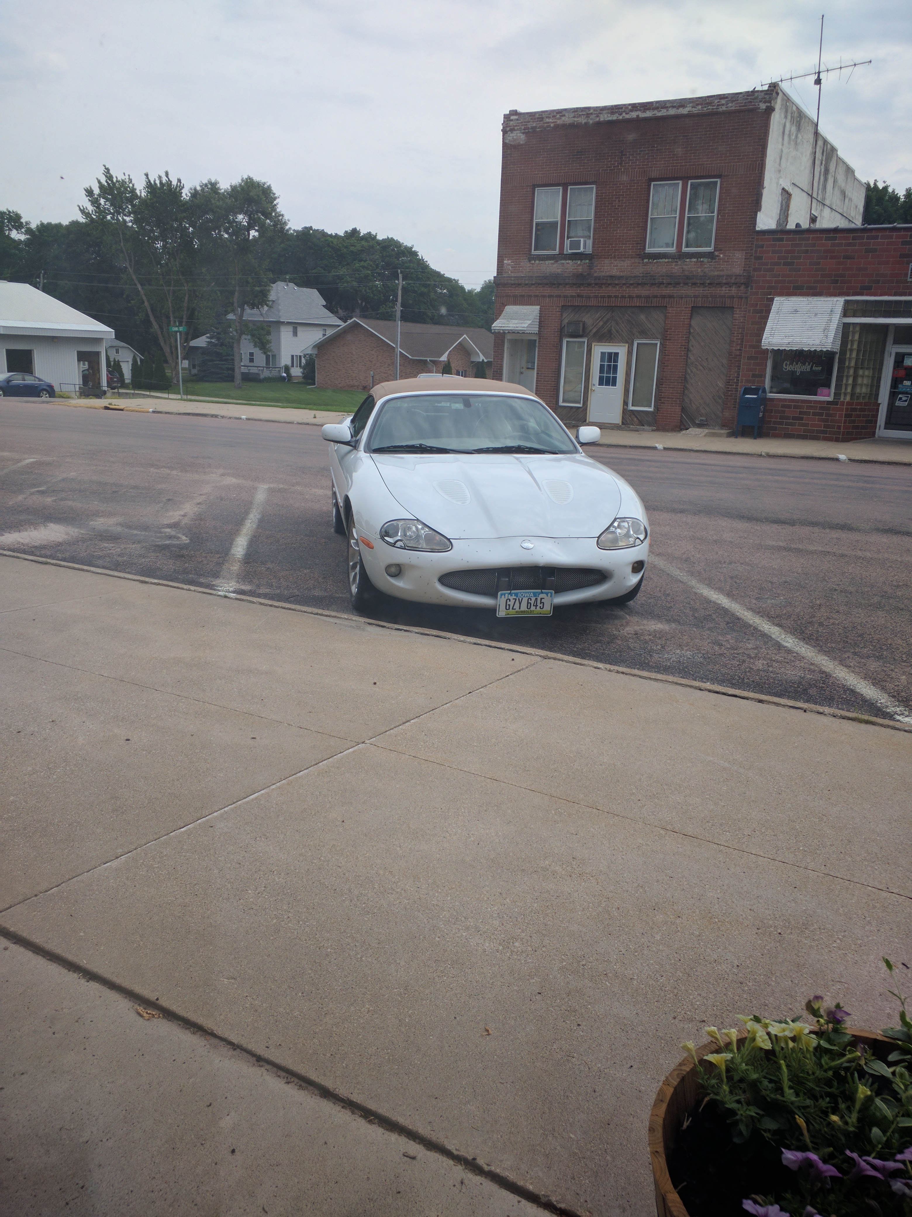

Anyway. Iowa inspection passed yesterday, and she's road legal! (Thursday June 7th). I left my 327 obdii bluetooth tool plugged in and used torque lite to monitor the car during it's 250 mile day. Yep. Put 250 miles on the OO R on it's first day out of the garage!. As expected some issues have crept up, but nothing that caused me to shut it down. Temp always stable at 195.7,
