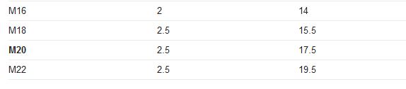

Ye of little faith. If motorcarman says M20 then it's M20. The drill size as you can see on the attached chart is 17.5 mm tapped would be an 18 mm hole.

Thanks Vern! New to Jaguar and to the regular Forum members, such as Motorcarman. I can see where Motorcarman is a regular contributor and knowledgeable person. This is just a learning process I am going through as a new owner of a Jaguar.

The M20x2.5mm toe eye is NOT Left Hand Thread!!!!!!!!!!!!!! .....
Bob,
I liked that photo in post #2 so much, I've added the thread to the FAQ's.
It may even save you having to repeat the advice every few months!
