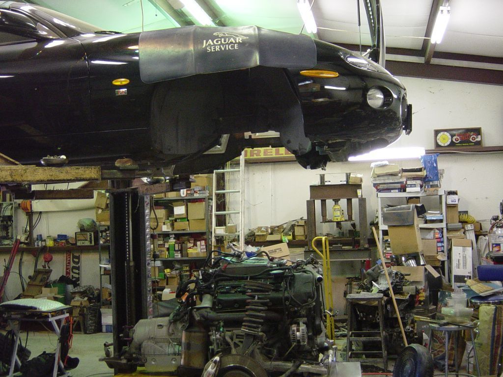

Update on the XKR.
I got another engine from a salvage yard that 'rikki tikki' found. The engine was delivered with the engine/harness all intact. Transferred all the ancillary parts/brackets etc.
New gaskets here and there. Bolted back up and running!!!!
bob
