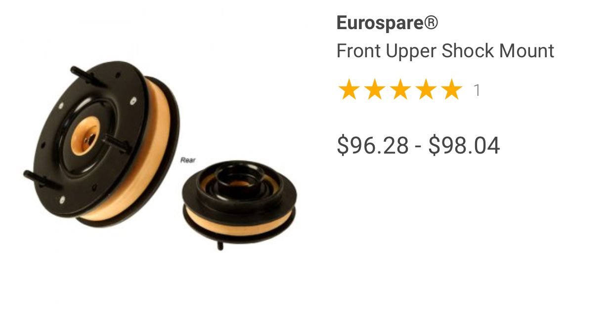

Old Apr 19, 2021 | 08:34 AM
Ledmi's Avatar
Joined: Dec 2018
Posts: 127
Likes: 56
From: Montréal

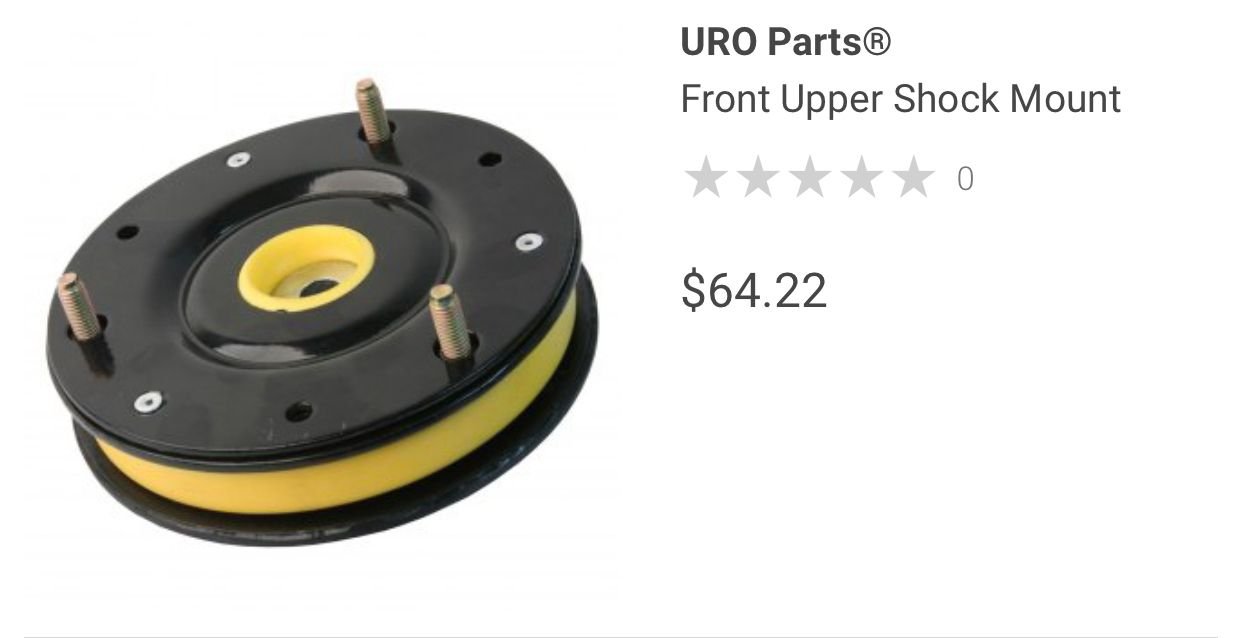

Default What about Eurospare or Uro parts ?
Does anybody have used those parts for your XK8 or XKR and what is your comments ?
Old Apr 19, 2021 | 09:22 AM
giandanielxk8's Avatar
Posts: 3,787
Likes: 1,676
From: Puerto Rico
I don’t know about Eurospare, but pertaining anything with the ÜRO name, run away as fast as you can. There’s nothing but atrocious quality with their parts.
