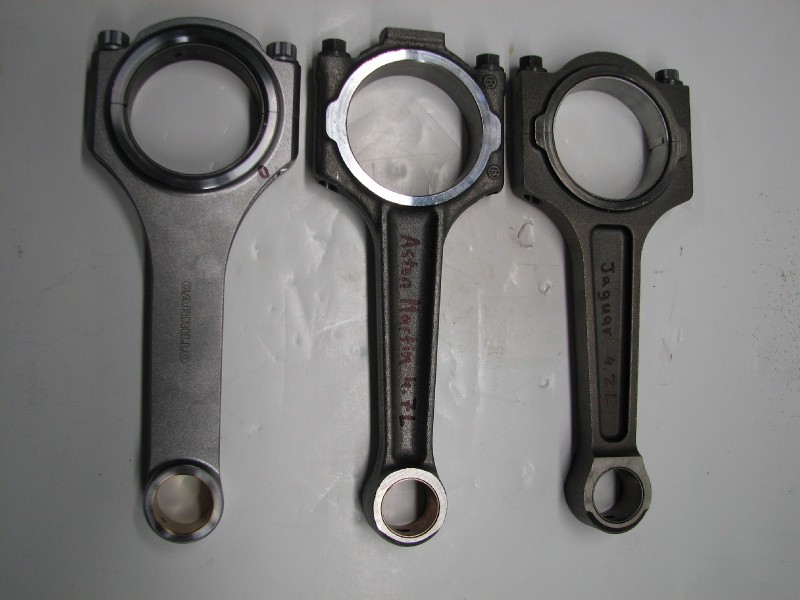

A couple of weeks ago I looked online to see what the rods looked like inside of a 4.2 liter XKR engine. I found a photo, but it was of a 4.2 rod sitting next to the rod from a 4.7 liter Aston Martin engine and a custom made rod that was put into a rebuilt AM engine. The photo was posted by a skilled engine builder named Pavel. The custom rod in the photo is designed for 900 hp levels.
I told Pavel about my plans to have another engine built at some point next year and that his high level of building interested me. He pointed out that the rods in our engines may be the limiting point when it comes to how much boost can be applied. I think that he said that they are made from a sintered or powdered metal vs. being forged.

Thats a carillo rod, they, oliver or the company i used pauhter can all make custom rods if you send them the stocker. They can change boresizes on rods, shorten or lengthen. I spent $200/rod on mine. That rod should be able to handle 2000hp as mine and olivers are. So should carillo's unless thats a spec'd less expensive hipo rod. My opinion is there is never anything wrong with over spec'd parts for reliabilty. The engine should be studded too with arp studs instead of bolts as they clamp much better(you need that to keep the heads down and head gaskets in place on high boost apps) and since they dont torque into the block threads theres less danger of damage
