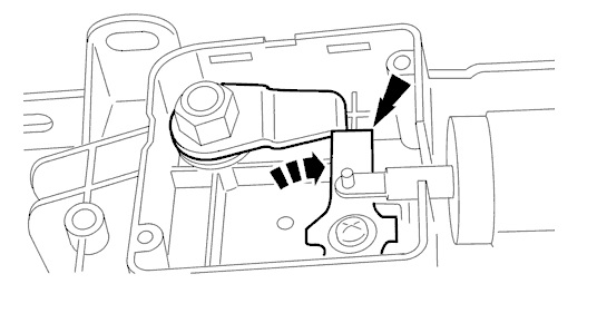

Can you hear the gearshift interlock solenoid 'clicking' when you press the brake pedal?
If so, is it actually moving the latch lever?

Like the title says...I'm getting pi$$ed off at the beast. Its on properly, checked fuses,connections, ect. With the shift illumination assy. removed, I can't shift out of Park unless I push the brake lock out tab manually. I assume that the brake lockout solenoid is the round metal gizmo that's about the size of a D cell battery with a shaft coming out to the little lever/tab? With key on, I get no clicking noise.With engine on I get no click when applying brake pedal. BONUS...! I'm now getting a performance reduced message, Transmission failed message, check tail lights message, and a brake light. I feel lucky indeed...Help,before I reach for the cyanide capsule and Luger...
