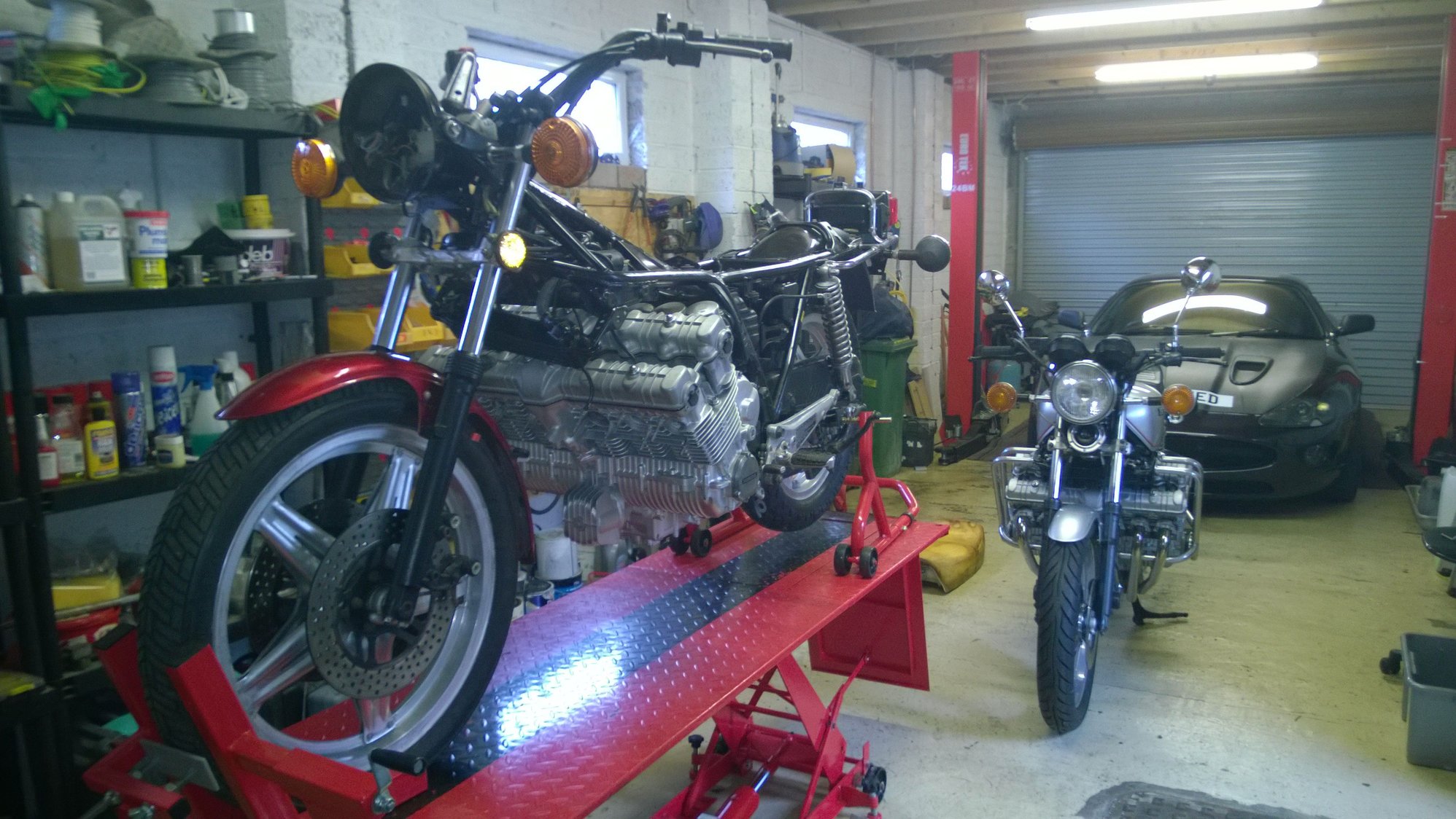

2 post lifts are versatile. Here I'm using mine to remove a motorcycle engine from it's stand.

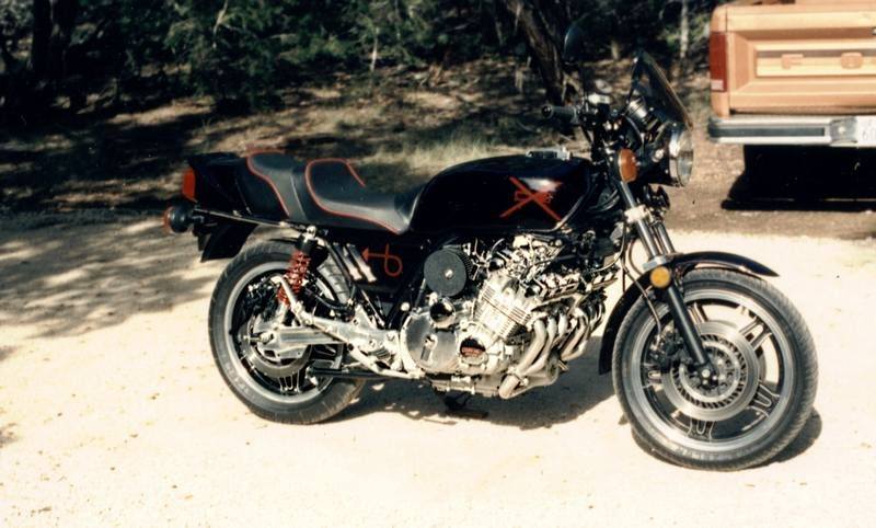

If you have a CBX, you better be posting more than just that photo!
Old Aug 16, 2019 | 12:09 PM
CaleyThistle's Avatar
Joined: Jan 2015
Posts: 53
Likes: 32
From: Scotland
One American spec and one UK spec.
I used to have a turbo charged 1979...what a hand full to try to drive.
