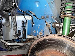

This is my 1997 washer bottle on my rhd car.
Don't assume the bottle itself is cracked or broken unless you are sure - the arrow on my photo points to a joint where a thin rubber tube goes over a plastic spigot. That's where mine was leaking, and a small cable tie (the little white one) around that joint solved the problem.
