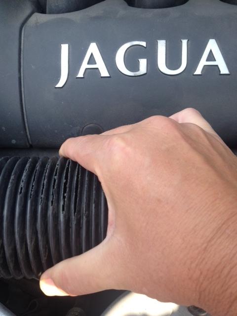

Mechanic recently removed this crusty brittle old thing and now show splits on top side (pictured) and underside.
Been getting "restricted performance" warning and no power over 3000rpm. I believe this is the culprit...(sucking unmetered air after MAF sensor).
Gonna do a quickie wrap with electrical tape to test theory, but need a replacement regardless.
Whats the name of this tube and any clue to the cost ???

Those cracks will indeed cause restricted performance issues once they get large enough....
I replaced ours in October 2012 after I found those same splits in the accordian pleats while cleaning the MAF sensor. It is called the Air Intake Duct. I negotiated the price down to $117. List price was about $140 or so. The part number for our 2006 XK8 was C2N1041....

Ditto for me. Tried wrapping with gaffer's tape as a first stop-gap approach, but quickly replaced. Amazing how brittle the darn thing had become.

Agreed. They get brittle after just a few years. Based solely on quality, it SHOULD be a $25 part....

It get brittle after a few years because it sits directly above the exhaust manifold.

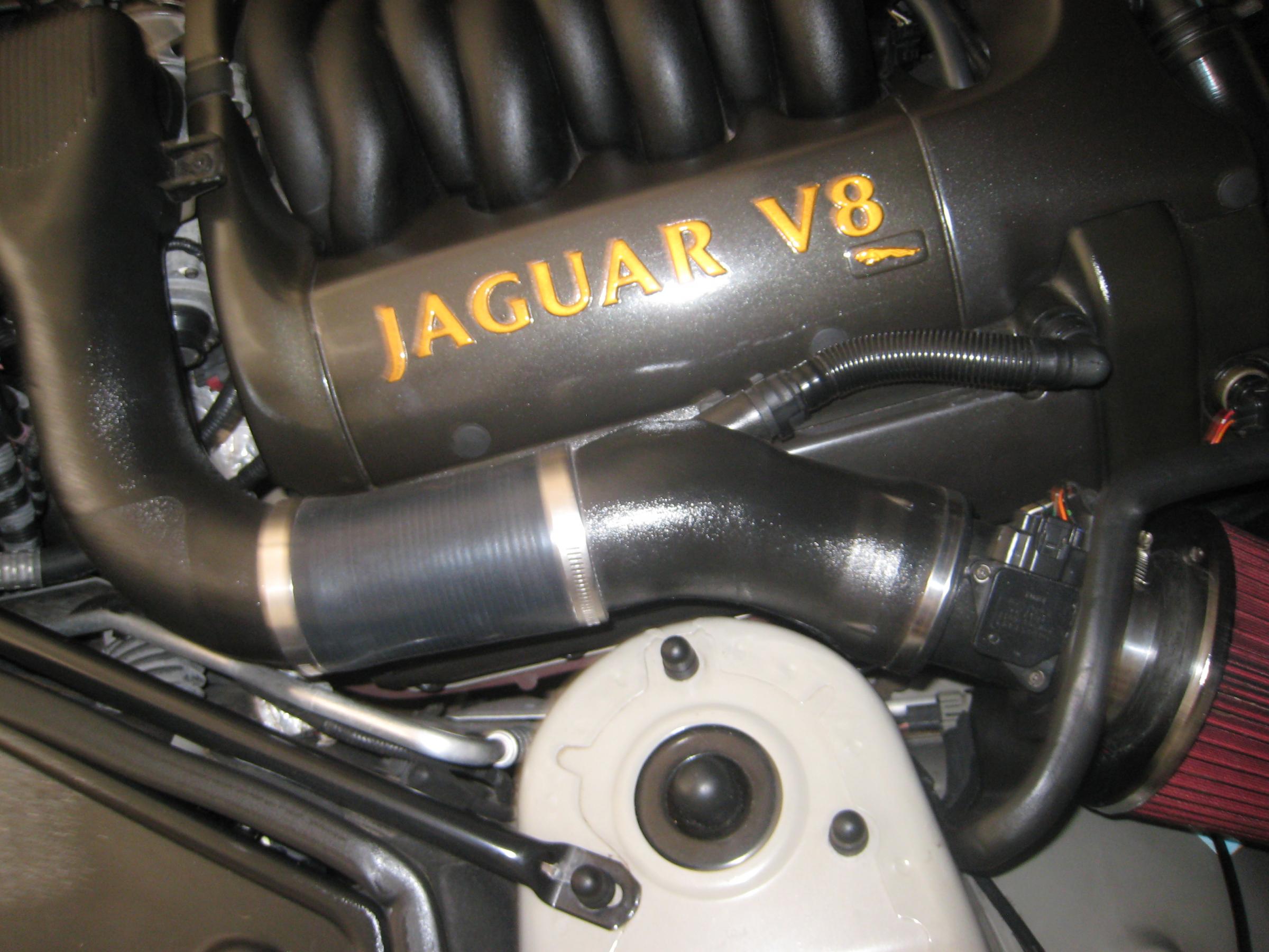

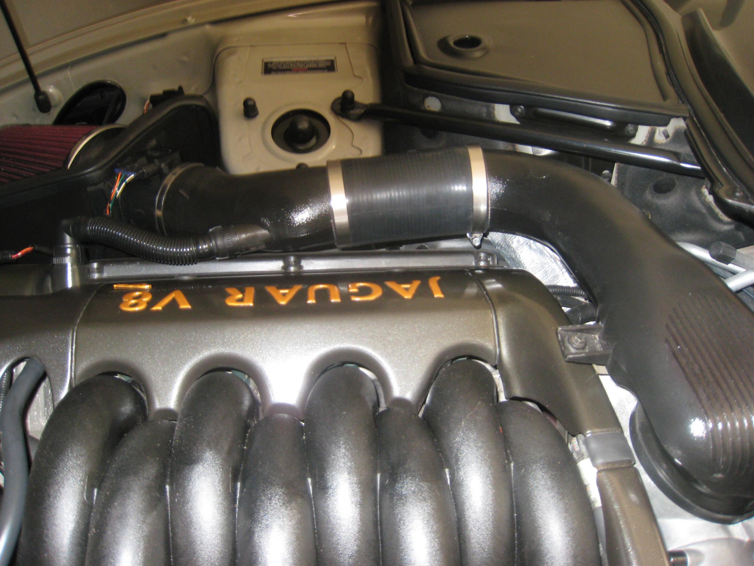

Here are a couple of pic's of the silicon pipe install on my 2001. Still believe the smooth surface will provide better air flow than air passing over the accordion.

Nice job indeed. I replaced my wife's XK8's worn-out intake air duct with the dealer part in October 2012. Still paid way too much for it even after negotiating the price down. If we keep her car long enough for the accordian section to get brittle and crack again, I'm going to implement your fix. Good luck with it and keep us posted....
