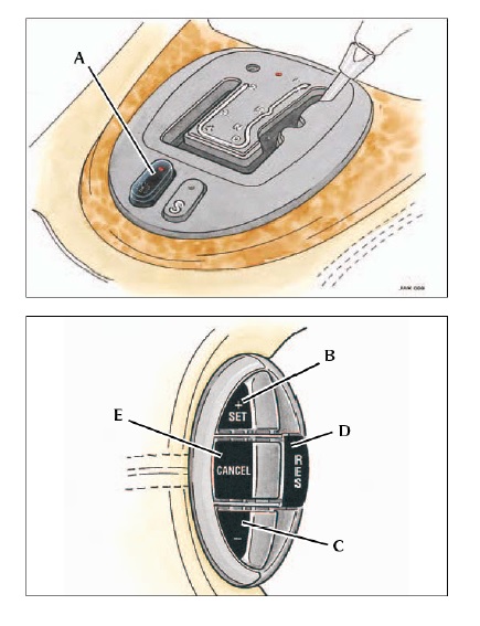

Standard Cruise Control:
Selection switch on the Centre Console and four buttons on the Steering Wheel.

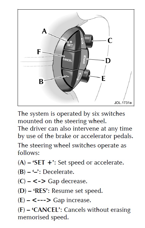

Adaptive Cruise Control:
Two additional buttons on the Steering Wheel to increase and decrease the gap.

So, single button on center console is adaptive? I was backwards. Thanks.

Yes; Adaptive Cruise Control loses its central console switch (leaving just the single Sport mode switch); but gains the 2 additional switches to the right side and below the cruise set switchpack in the right quadrant of steering wheel - as pictured by Graham.

The added steering wheel switches seen in Graham's post are used to set the "gap" . . . but commonly overlooked or poorly understood by most drivers. By default on both my ACC equipped Jaguars and a couple more I either work on or know, and irrespective of subsequent changes, each drive cycle resets the "gap" to maximum distance (sorta like max "sensitivity"). Normally, even on sweeping bends, the Jags will ignore a far slower car in adjacent lane . . . brilliant, sorta like seeing around corners, but . . .
Depending on speed and separation, this can produce rapid deceleration of your car when a far slower car changes into your lane, despite being quite some distance ahead. Unnerving for you perhaps . . . but downright frightening for the chap following you, who is now clambering up your exhaust pipes and wondering what the *+*+* you are doing! Adjusting your ACC "gap" avoids the issue.

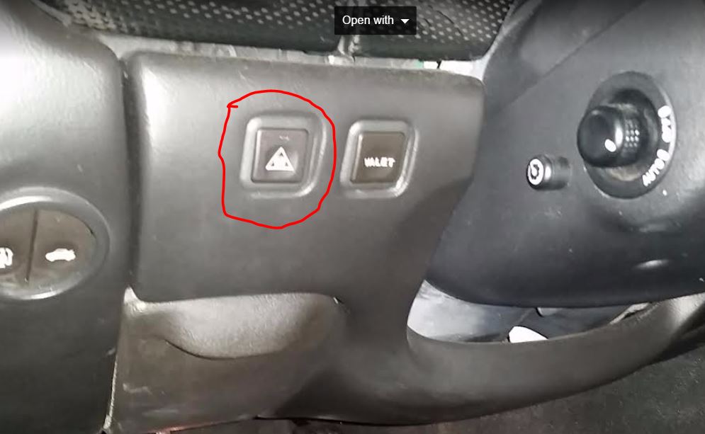

Here are two pics for how you can tell if the car has adaptive cruise. One is the extra distance control buttons on the steering wheel and the second is a button on the lower knee bolster next to the Valet button for the "Forward Alert" warning feature that also uses the radar module for the adaptive cruise (ACC). This button sometimes is easier to spot in pics on car sales websites than the ones on the steering wheel. If the buttons not there it will be blank or have a vent there.
Most descriptions that I have seen on the websites don't even note that the car has adaptive cruise. Probably because its rare and they don't know how to tell its there. I love using it on the interstates once I got used to it.
Attached Thumbnails Adaptive cruise control-adaptive-cruise-control-buttons.jpg   Adaptive cruise control-adaptive-cruise-front-hazard-warning.jpg

The little button by your knee will scare the crap out of you! You forget the thing is on and you get into traffic and then "BRAKES COME ON"! and the smell seems like it will never go away!
