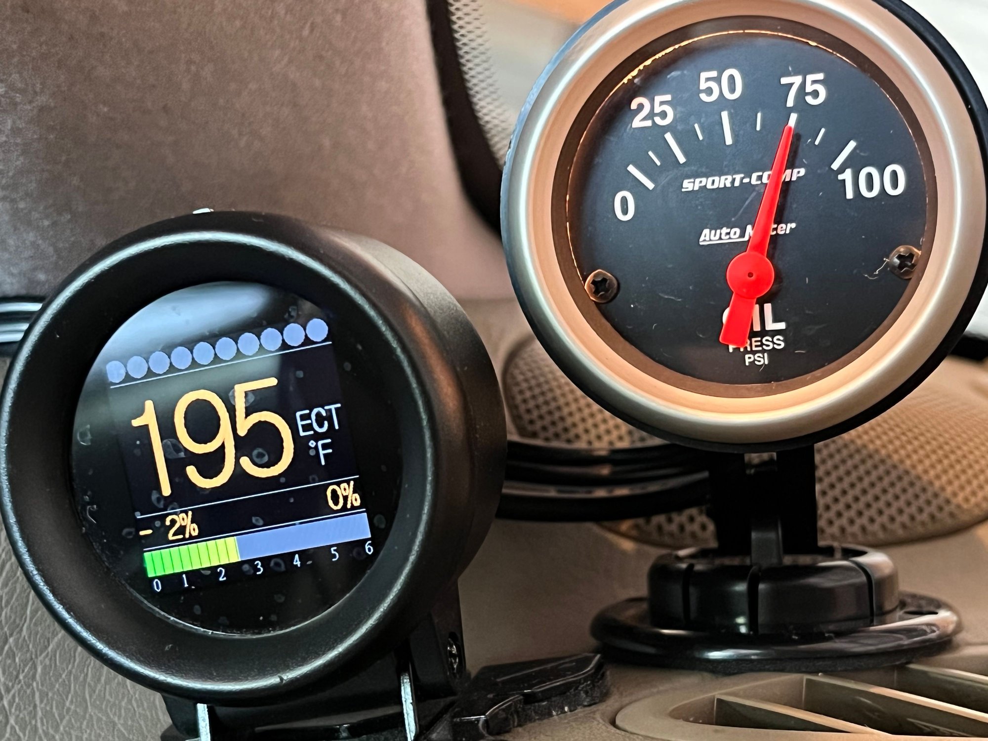

when my 3 year old Jag branded hose failed I was going down the highway at approximately 75 mph. Judging from the oil slick which I observed later from the seat of a tow truck, it took less than 1-2 minutes for all the oil to spew out and activate the oil pressure light.
i was able to shut off the engine before any damage occurred. I now have an oil pressure gauge with a warning buzzer when the oil pressure goes below a designated pressure.

Originally Posted by Feral Barncat
zray.....Where did you plumb in the sender for your oil pressure gauge?
Thanks!
It goes into the same location as the factory oil pressure sending unit.
the people that make the “real gauge” set also sell the adapter separately.
https://www.thejagwrangler.com/jagua...e-adapter.html
a really well made nice piece.
Z
