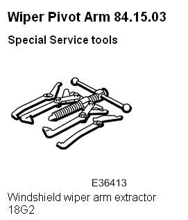

... my wiper arm that is.
I can't get passenger arm off to save my life!! The car's been in houston for most of its life, not a spec of rust on the undercarriage or suspension, but these retainer nuts were like from a scenen out of Titanic. (I kid you not)
Soaked both with WD-40 and then some Blaster stuff, driver side finally shook loose. Nut is off, but the arm is still stuck to the 'bolt' on the passenger side.
I don't have the fancy extractor as recommended from the JTIS
so I thought someone might have another trick to get this frustrating arm off.
thanks in advance!
Attached Thumbnails Ahhh! My arm....-wiper-extractor.jpg   Ahhh! My arm....-img_0791.jpg   Ahhh! My arm....-img_0794.jpg

Matt, with the arm in the up position I grab it and work the hole thing up and down. This works the part attached to the serrated shaft and has ALWAYS worked for me

A puller is ideal and in most cases the only way to go. A steering wheel puller is similar but you may need to make a plate to go under the arm. I have one but not with it to give you an idea of what it looks like. Look at this one http://www.sears.com/shc/s/p_10153_1...6905000P?mv=rr Wd-40 will not cut the rust like the PB Blaster will. Let It soak overnight and tap the sides of the arm and see in it comes loose. NOTE I SAID TAP!! Not sure how the arm is mounted as to the damage it may cause.

I had the same problem with my wipers. I went to Autozone and borrowed a puller and popped the wipers off in their parking lot.

Brute force worked after a couple hours of soaking in the blaster. My hand is killing me though from all the vigoroush yanking. (no jokes please)

The wiper puller is about $7 at any AP store (except NAPA, of course). Takes about 30 seconds to remove the arm. The plastic cap is available at Lowes for about $2 for 2, 7/8" Good dark gray color match.

You bring up this issue and ive gone 13 years never having this issue.........till today. Couldnt get the passenger arm off a xkr either. So just put the nut on and tap tap tap with a hammer to loosen...came right off....now lets talk about winning the lotto.......
