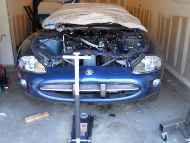

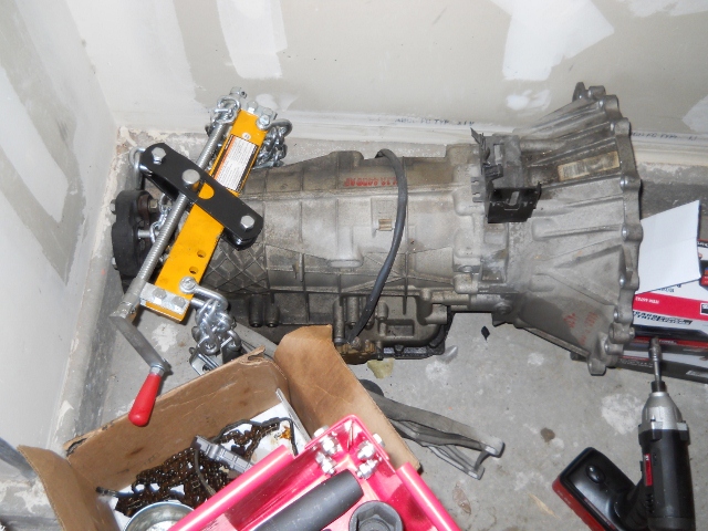

just a few more months and shes back on the road
Attached Thumbnails almost finished with my prodject. tanny and engine-003-640x480-.jpg   almost finished with my prodject. tanny and engine-001-640x480-.jpg   almost finished with my prodject. tanny and engine-004-640x480-.jpg

well, my transmission started making that clunking noise. I realized it was that ring going out in it. I decided to take the engine and transmission out of the whole car and do the timing chain job completely(out of car). I am waiting for a remanufactured hp transmission -torque converter and all. Yes I've been doing this type of work on amercan cars and I found out that its all the same minus special tools. I put together and took apart that timing mechanism 10 times just to make sure I had it right. Im ready to drop it back in and get rolling.

coupe when do you plan on doing it? Im way on the west coast. dang that would be a fun project, rebuilding the whole engine. but I must warn you. I paid around 700 for the timing chain kit. that included the whole thing 4 guides, 4 tensioners, timing cover seals vvt seals, upper seals for valve covers (which i didnt need). i went thru christophers in new jersey for that deal. oh yea and 4chains. I said what the heck and purchased the special tools thru motor cars for 300. once I took the engine out, I realized that I needed new motor mounts. mine looked like toast. i tore the wire from the crank shaft sensor so i needed that. My water pump have the black prepellar so Im puting it back on. this job for just the engine is about 1600 so far. the tranny itself is 1700 . So I could imagine what rebuilding this aluminum block would cost. Oh yea i broke a bolt in one of the timing guides. I had to put the whole engine in my pickup and take it to this race shop. a specialist their repaired my screw up.

that cost me 100 bucks to drill it out and put a insert. dont try to abstract a bolt out of an aluminum engine unless you know metal work. those blocks melt like plastic once heat from a drill bit is applied
