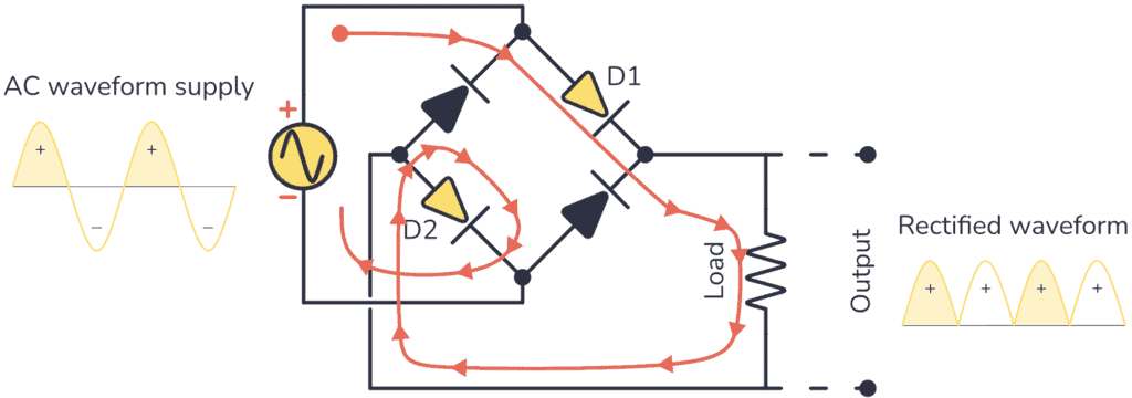

Just to illustrate why only one diode has to fail internally for current to leak back to ground, here's the simple form of rectification with 4 diodes:
As the generator produces the positive-polarity half of its alternating-current wave, the current through the diodes takes this path:

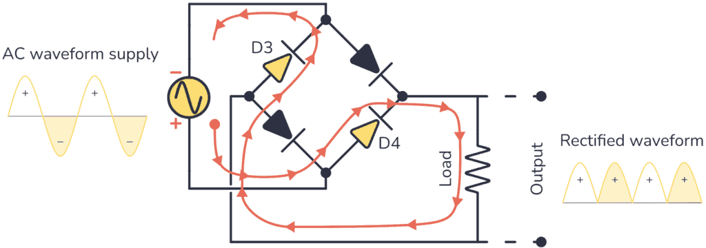

As the generator produces the negative-polarity half of its AC wave, the current takes this path through the diodes (note that the direction of current flow through the load is the same):

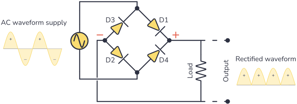

For each half of the generator cycle, only two diodes are conducting current.

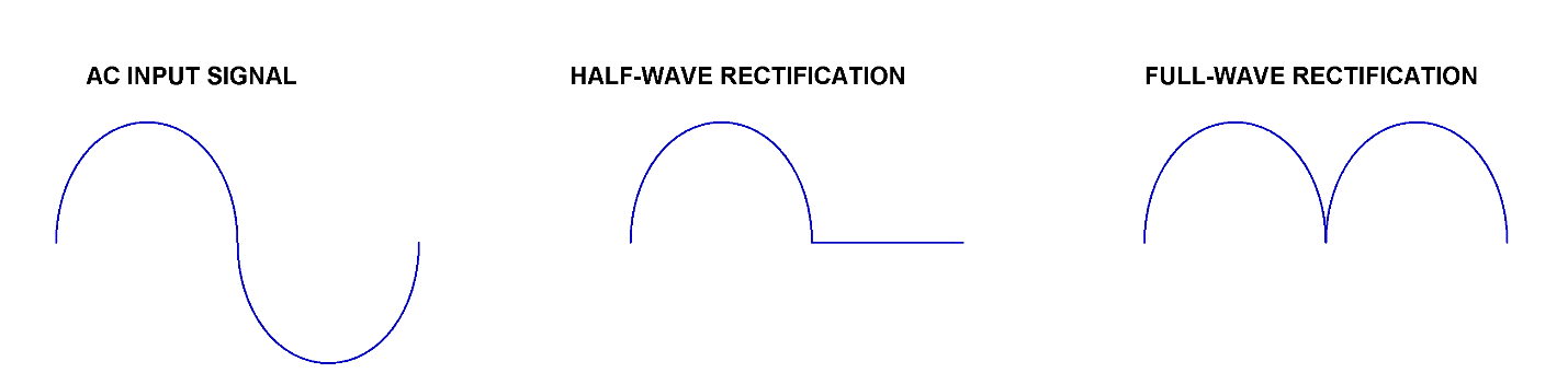

The two legs of the circuit that connect to the load also connect directly to the positive and negative terminals of the battery. If one of the diodes breaks down internally, so that it conducts electricity in both directions instead of only one (becoming a resistor instead of a diode), battery current will be shunted directly to ground. Usually, when the diodes bridge, they form a high-resistance short of dozens or hundreds of ohms, so they do not constitute a dead short (0 ohms). But it's enough to drain the battery when the engine is shut down.
If one diode bridges, the alternator will still produce positive voltage, but it won't be fully rectified:
