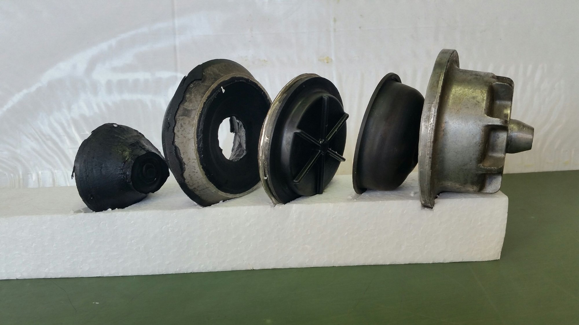

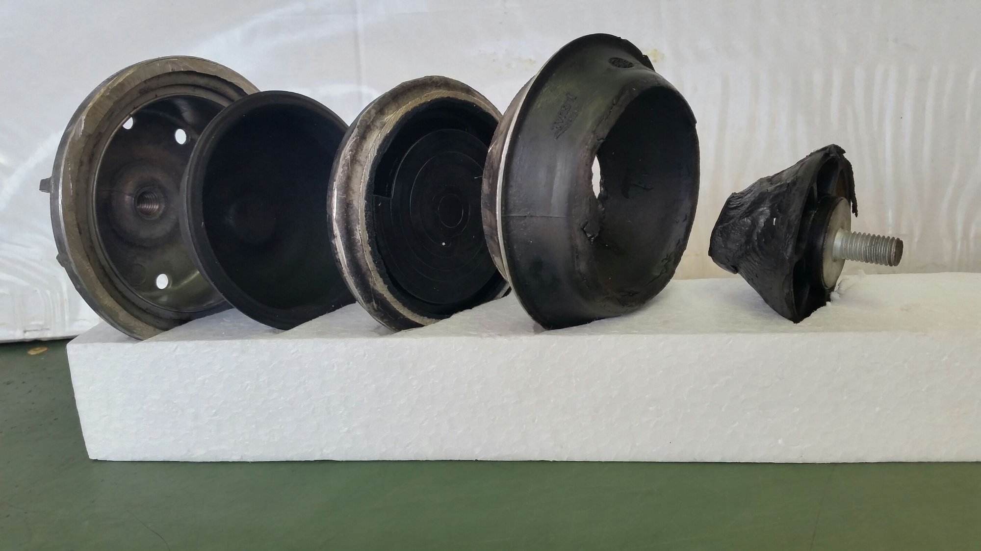

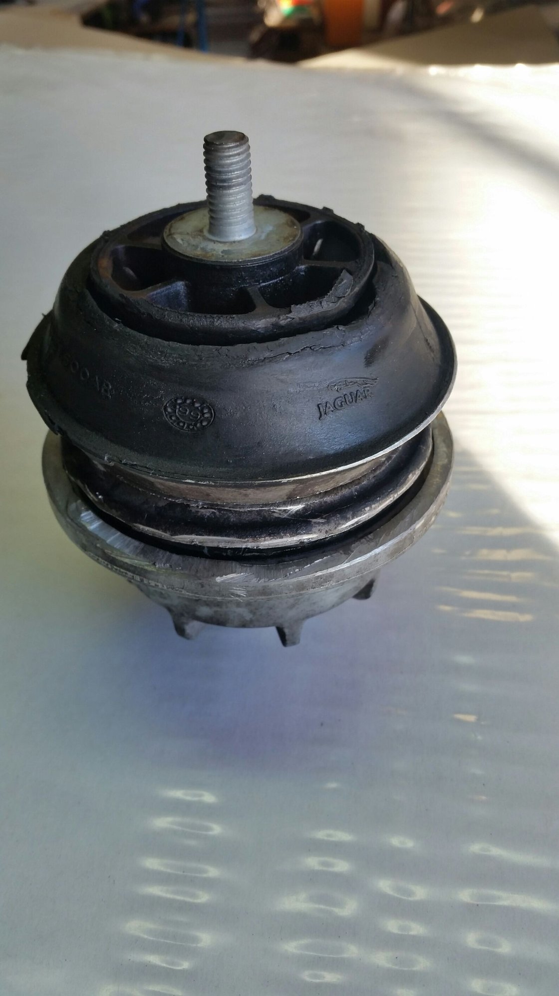

I have a failed engine mount and in the process of changing it out thought a breakdown of the components within may be of interest.
pics show the main body, the bladder, valve plate and the upper section of mount.
Upper section normally includes the fixing stud which has separated on mine, hence the failure.
l am not sure what fluid is used in these mounts but some use a mix of water and glycol.
