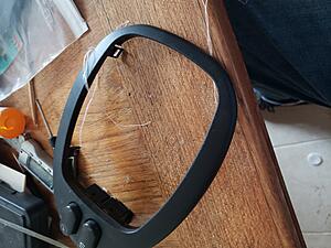

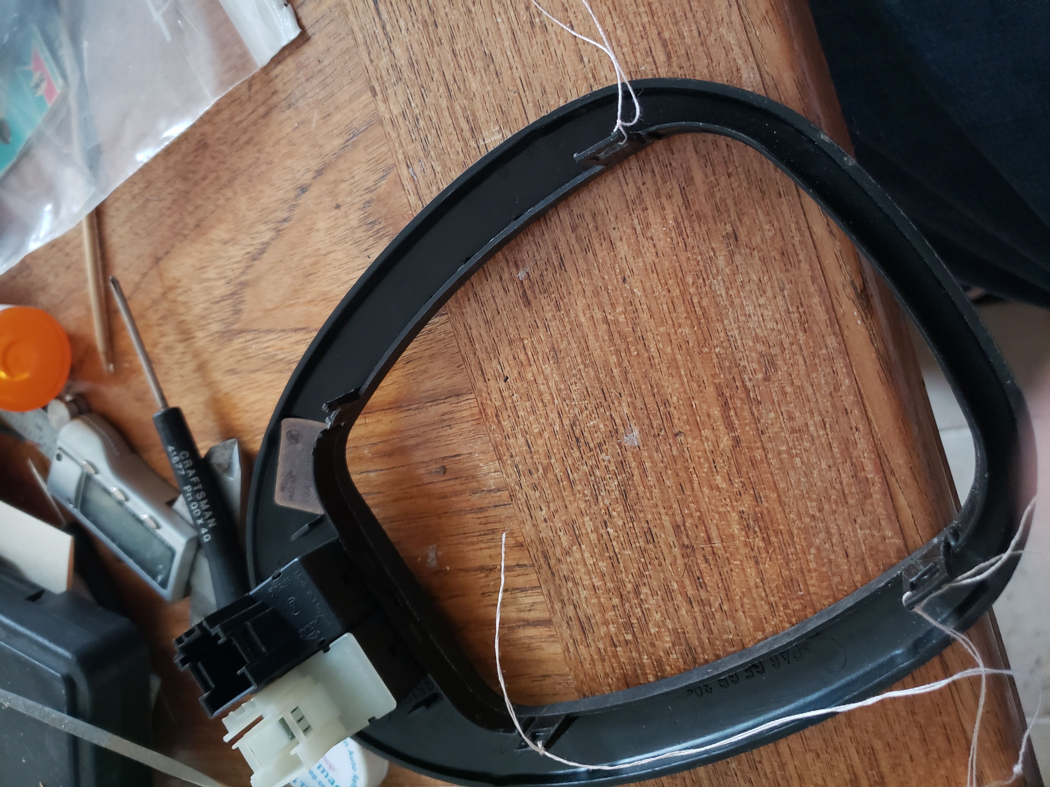

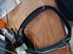

Morning guys. I have to admit, this is one job where practice doesn't help. I spent about 30 minutes trying to unhook the darn tabs holding the gear selector surround in place. This must be the 12th time I've done it. . . Doesn't get any easier.
This morning it occurred to me - what takes all the time? 1) locating the tabs precisely 2) wedging a flexible piece of plastic in there and simultaneously pushing the tabs back.
I decided to tie thread around each tab. Next time I want to take her off, I'll just pull the end of thread out of hiding and hopefully with a small tug release the darn tab!
Heck, even if it doesn't release at least ill know exact where the dam tab is :-).
John

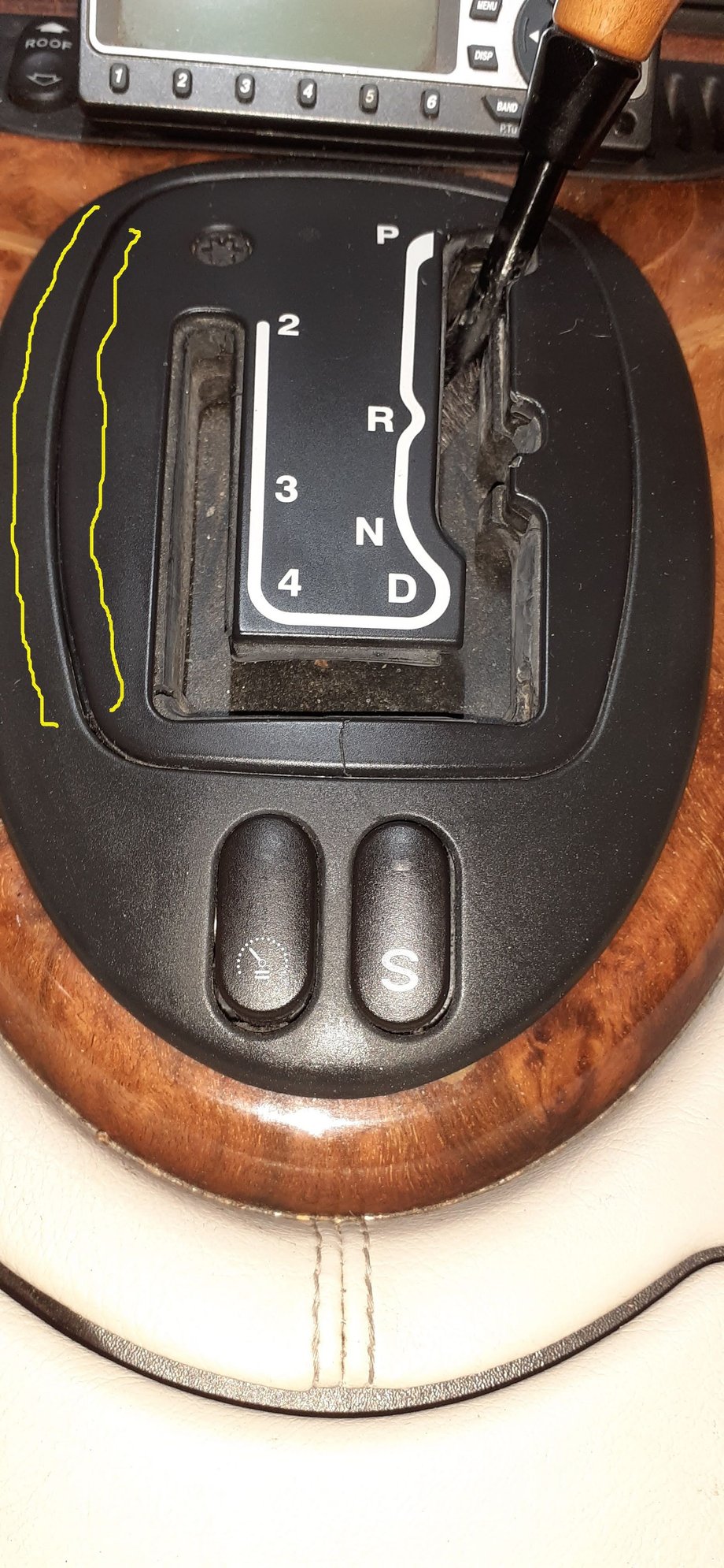

How does the cruise control button attach? Mine has fallen in so it doesn't sit at the top. The button still works but it is hard to press because it just goes further down into the void.
Old Feb 24, 2022 | 10:46 AM
Johnken's Avatar
Posts: 5,457
Likes: 1,816
From: New Jersey USA
Rollins, there are / were plastic tabs that it attached to.
2 answers. Use 1st if the bottom of the switch has a flat plane unobstructed by the wire connector. Use 2nd otherwise.
(1)
Here's a trick I've used. Loctite clear (self mixing attachment included) sticks to the black plastic surround. It also sticks to black wire ties!
This epoxy is available at amazon about $4. Either Lowes or Hdepot carries it, not both. Its the self mixing attachment you must have IMO. Buy 10 inch long wire ties. Your life will be easier if the ties you buy have "teeth" on both sides of the tongue (9.25 inch male part).
Take 3 or 4 ties. Cut the head plus 3/4 inch off two. Save the remaining strip
Remove the switch.
Dab of epoxy on the flat space next to the switch. (Frankly it wouldn't hurt to scuff up the area for the dab). Lay one of the strip + female receptacle on the epoxy. It, this first one's orientation doesn't matter. BUT! don't glue down the head - you need access to insert a strip once it dries overnight. [Wrap the head in painter's tape, wax paper scotch tape]
Now plan the position of the other wire tie head. You need the accepting part to face the switch when bent up. The strip can only enter the head from 1 direction.
Dab of epoxy, protect the head, let dry over night.
Next day.take that cut off strip feed it through the 1st head you worked on (see this is why it's orientation didn't matter, you can insert from either side.)
Place switch in position.
Wire tie over switch into head #2, tighten wire tie to hold switch in place. Cut off useless protruding ends.
Need to work on switch? Cut wire tie & use a new one.
(2)
Go to Harbor Freight. Buy a $20 plastic welder
Use it to weld the old mounts to the switch. Add plastic cut to size to secure the switch.
Just be careful not to intrude on that part of the plastic switch that channels the press on press off movement inside the switch housing.
The plastic welder is pretty similar to a soldering iron. Its tip, a triangular flat surface, is heated to the point it melts plastic that it touches. It comes with spare plastic patch pieces, but old plastic laying around the house works too. Surprisingly simple to use.
I hope these ideas help. The wire tie worked better than new for my roof switch!
BTW I recommend you avoid "plastic epoxies" i haven't found one that works yet! (Thats how I got to my plastic welder BTW)
John
