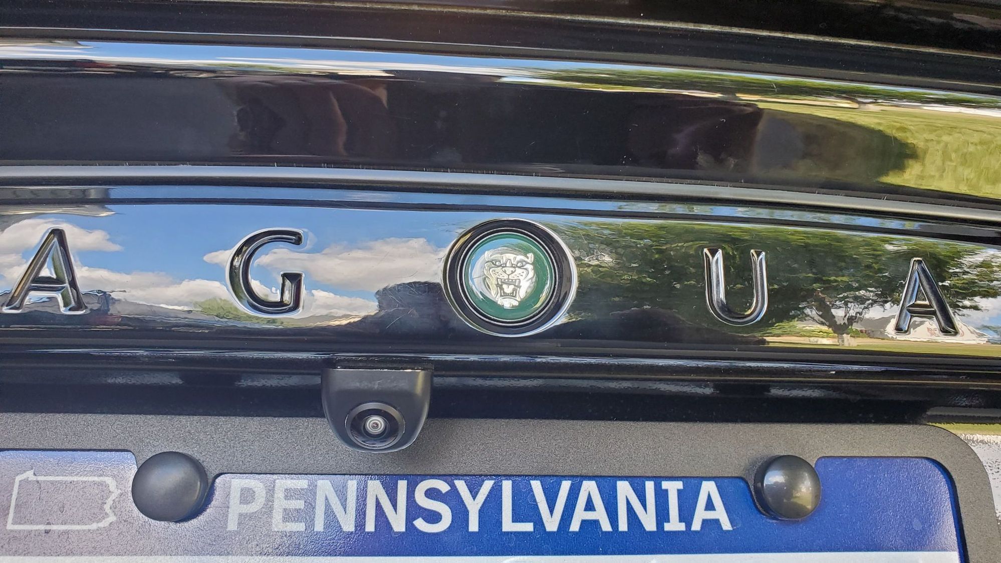

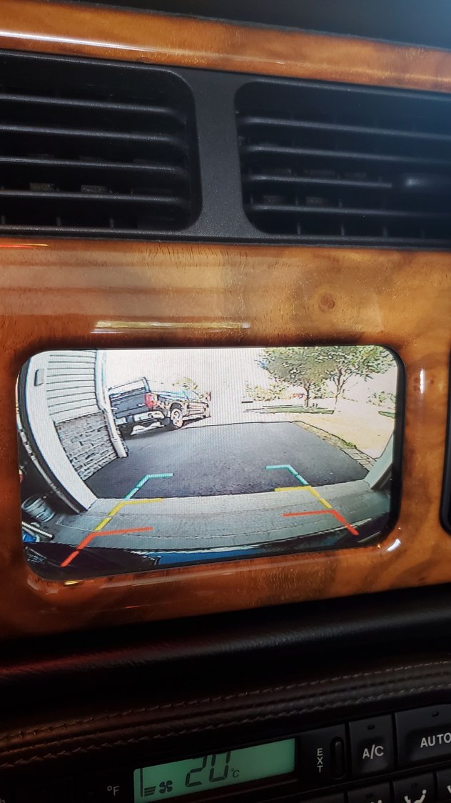

It has been over a year since my first attempts at getting a backup camera working through the OEM screen on my XKR, and I have now finally met with success. Lots of embarrassments and frustrations along the way, biggest being that I probably had it working on my very first attempt, just didn't know it. Turns out that with the PAC VCI-X unit, there is a delay of 2-3 seconds from when you engage reverse before the camera image pops up on the screen. Every time I tested the system back then, I immediately took it out of reverse when I didn't get an image, and then tried to troubleshoot for a problem that wasn't there.
I know the most common recommendation nowadays is to replace the OEM screen with an aftermarket unit that has higher resolution and usable navigation, but I really wanted to keep the stock look, and this works well enough for my needs. Note that the camera had to be placed a bit off-center as the mounting stud would not fit behind the trunk button assembly.
