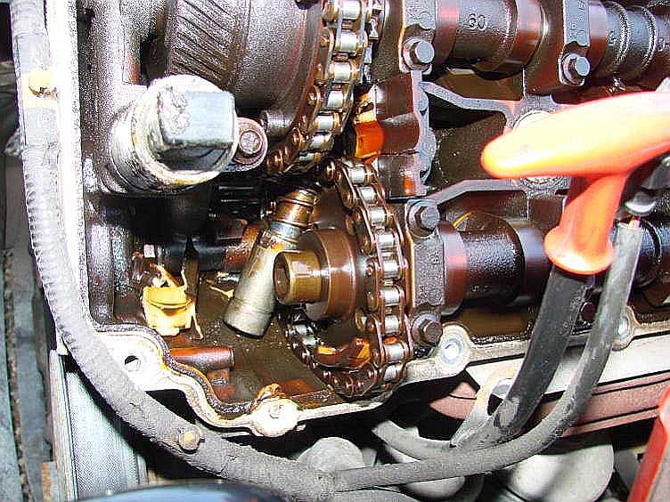

Here's an update: My mechanic pulled the PS cam cover. Very disappointingly, the guides and tensioners are plastic, despite a 5/02 engine code and build date. He told me the chains, tensioners and guides all look fine (on that side, at least). As controversial and unpopular as this may be, even with 90k miles, I am NOT going to replace the chains, guides and tensioners. I don't plan to put many miles on the car, and my mechanic will indicate in the paperwork that one bank was inspected. Sorry, but I just don't want to get into the whole replacement, especially since I'm much more into the car than its worth already.

Some Plastic Tensioners

There is really no need to replace everything at this time, but the secondaries are not that expensive or difficult to do using the zip tie method.
Your mechanic isn't the one at risk of losing an engine.
Understood, but I'm certain he wouldn't mind making an extra buck if he felt it prudent to do the work. I'll have a look at the tutorials for the zip tie method.
