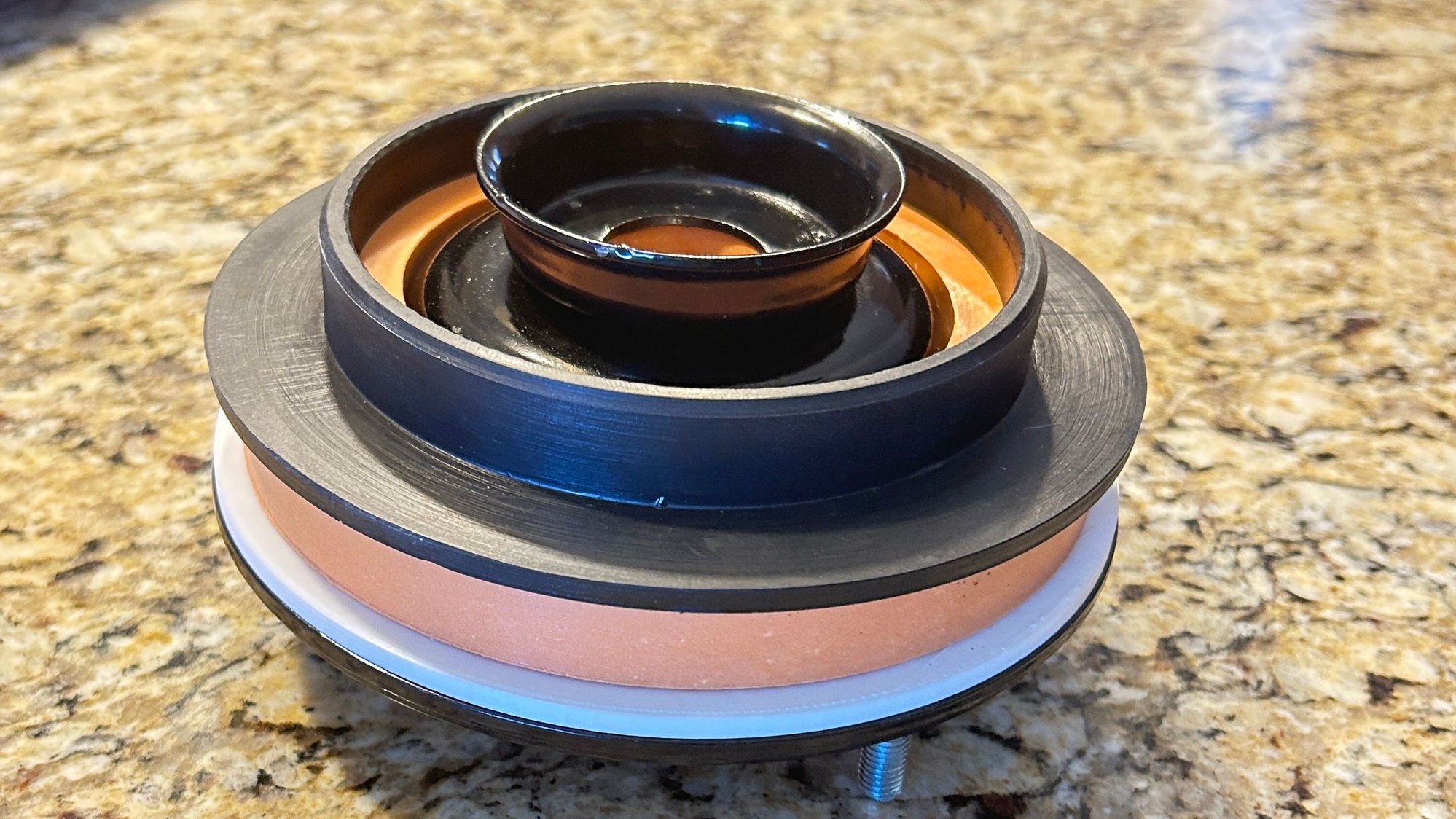

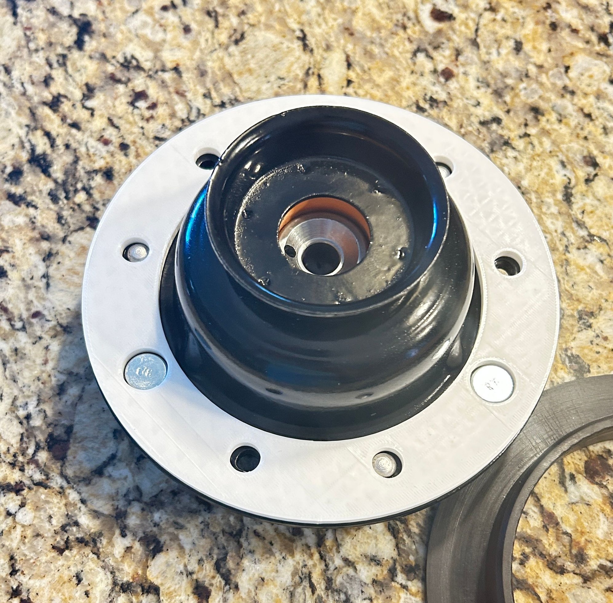

[QUOTE=bturner425;2921254]I’ll post photos and the .stl file after I print it.[/QUOTE
Here are photos of my URO mount stud spacer. Hopefully, this will prevent the PU isolator from getting deformed by the studs.
