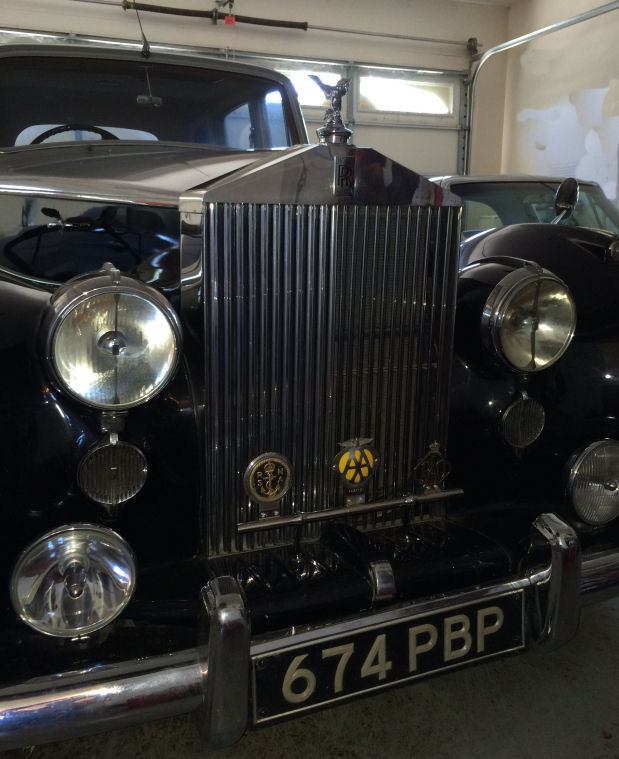

Off topic is fine with me anyway, as I have received good advice that might be useful to others in the first two responses above.
Yes, we enjoy driving the Silver Dawn and it gets priority parking spots when we go to events or out to dinner which is nice (and somewhat amusing to me). It is actually a fun car to work on. I recently tackled a rebuild of the differential and updated modern rear axle bearings along with new axles (worn splines). As you may know these have the GM Hydramatic 4 speed and it still shifts fine and drives smoothly with apparently only minor adjustments over all these years. Ashley James' website Home | KDA132 is an extremely useful resource for technical information and provided all the information needed for the updated axle bearings for example. Flying Spares and Albers Bentley Zionville can supply almost any OEM part needed. (take that Jaguar who has apparently decided that pre 2003 Jaguars no longer deserve 100% parts and software support).

Mine had the 4 speed manual trans. I got to know Tony Handler there in CA real well over the years for parts and owned a few other Rolls and Bentleys over the years. I sold my Silver Dawn about 5 years ago to a guy in GA because a friend had been let me store it in his warehouse but he sold it and I lost my indoor storage and I have no garage. After keeping it in the driveway under cover for a while I got tires of seeing it deteriorate and put it for sale. I do miss it. It was funny that that tank got 20 mpg. Drove really nice.
