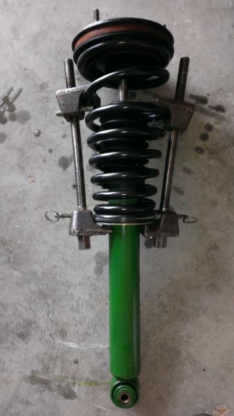

I used one like this. Got it as a free loaner from AutoZone.
Attached Thumbnails Been on jackstands as much as on the road ...-rothwell-5131-albums-2004-xk8-7693-picture-wp-20130901-008-20142.jpg
