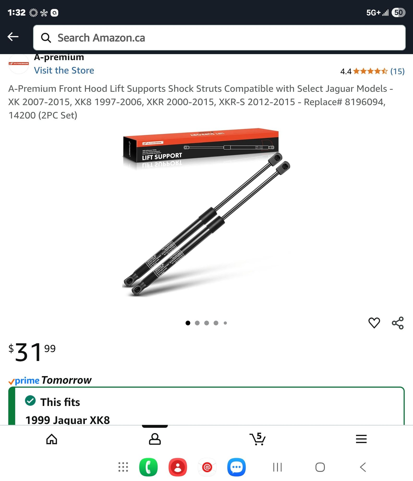

I bought these in January and they are perfect so far. Only had the bonnet up and down about ten thousand times since I replaced the old ones though lol. The name is A premium so they must be good right?
The price is in Canada funds btw.

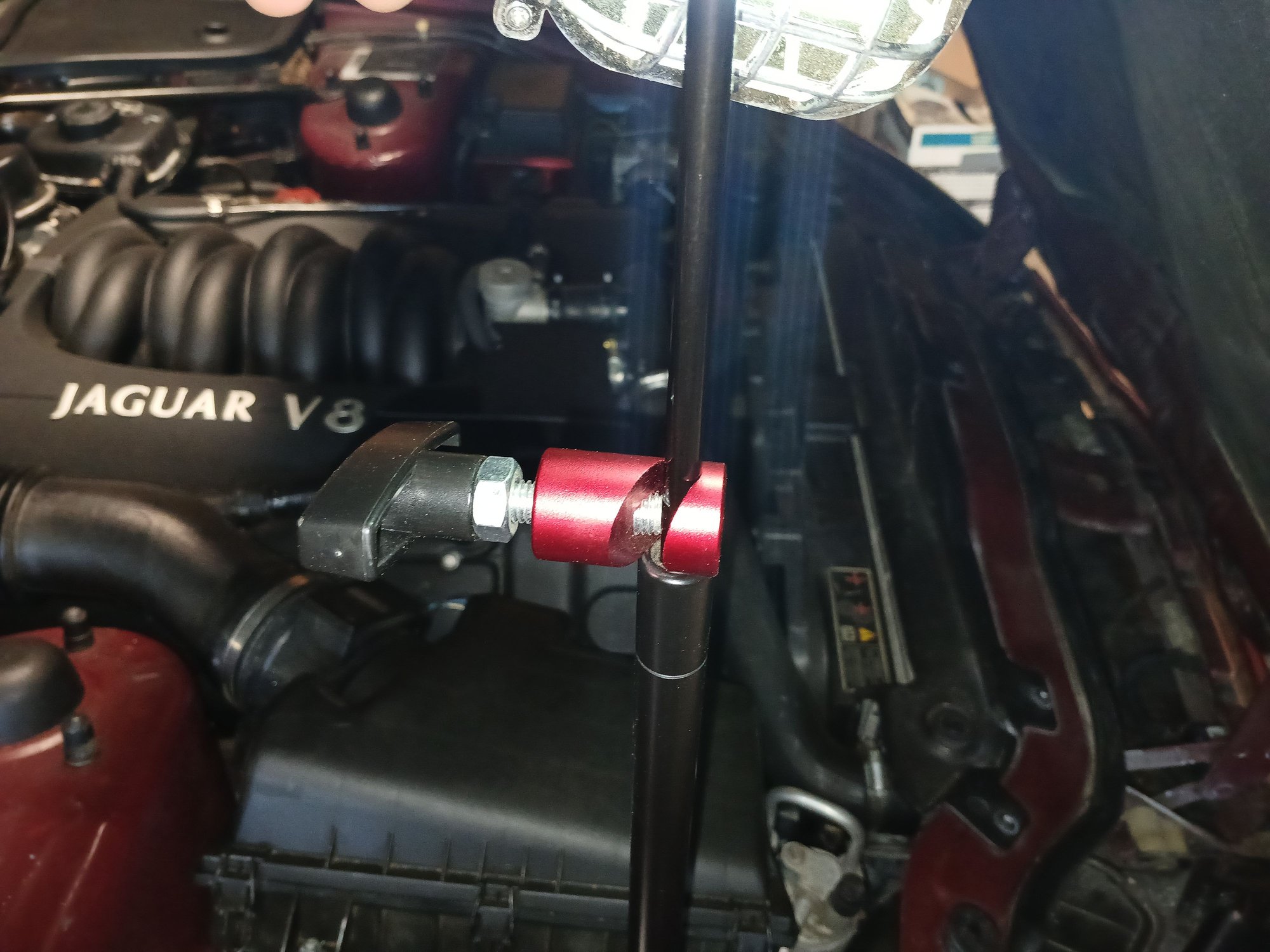

I have replaced the hood/bonnet struts on both my 99 and 98 XK8's in the last few years, Most recently the 98 in May 2025. Both sets are no longer able to hold the h/b open. I could not find where I purchased either set, but both sets are stamped, "LIFT-O-MAT" and "STABILUS HJA 2500 AB". I usually buy this kind of parts on Rock Auto or Amazon. Guess I'll have to try another brand. In the meantime I keep a red screw on lift lock in the console–$8.99 a pair.

Here you go, as low as 6.99 a pair on Amazon. There are other styles available on both Rock and Am. I like to have one on whenever I'm working under the hood longer than momentarily, just in case.
Installed
Installed

I have several different makers/styles of that type of holding device and I rounded the bolt end on that one to minimize the chance of damage to the rod.
The other styles already have rounded bolt ends so I copied the idea.

Sounds good to me! I saw one on Am that looked like it might be a cam-lock style that would be easier to fasten with one hand while holding up the hood with the other, and one on Rock that was described as "magnetic".
