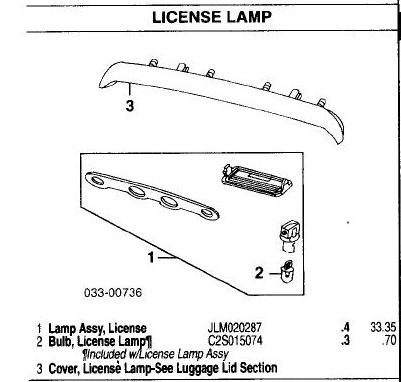

You will need to remove a couple of screws that hold on the carpet in the inside of the boot lid. You will then be able to access the bolts that hold the plinth on. Mine was cracked & I was able to repair the first time. Then about a year later it was too damaged to repair. Ordered a new one from the dealer. Problem is that they come primed in grey & you will need to take it to a body shop to get it painted to your color. Mine is solid as a rock now. Make sure when closing the boot lid that you don't push on the the plinth in effect using it as a handle. Over time, that will damage it. Use the handy leather strap on the inside of the lid to close it.
