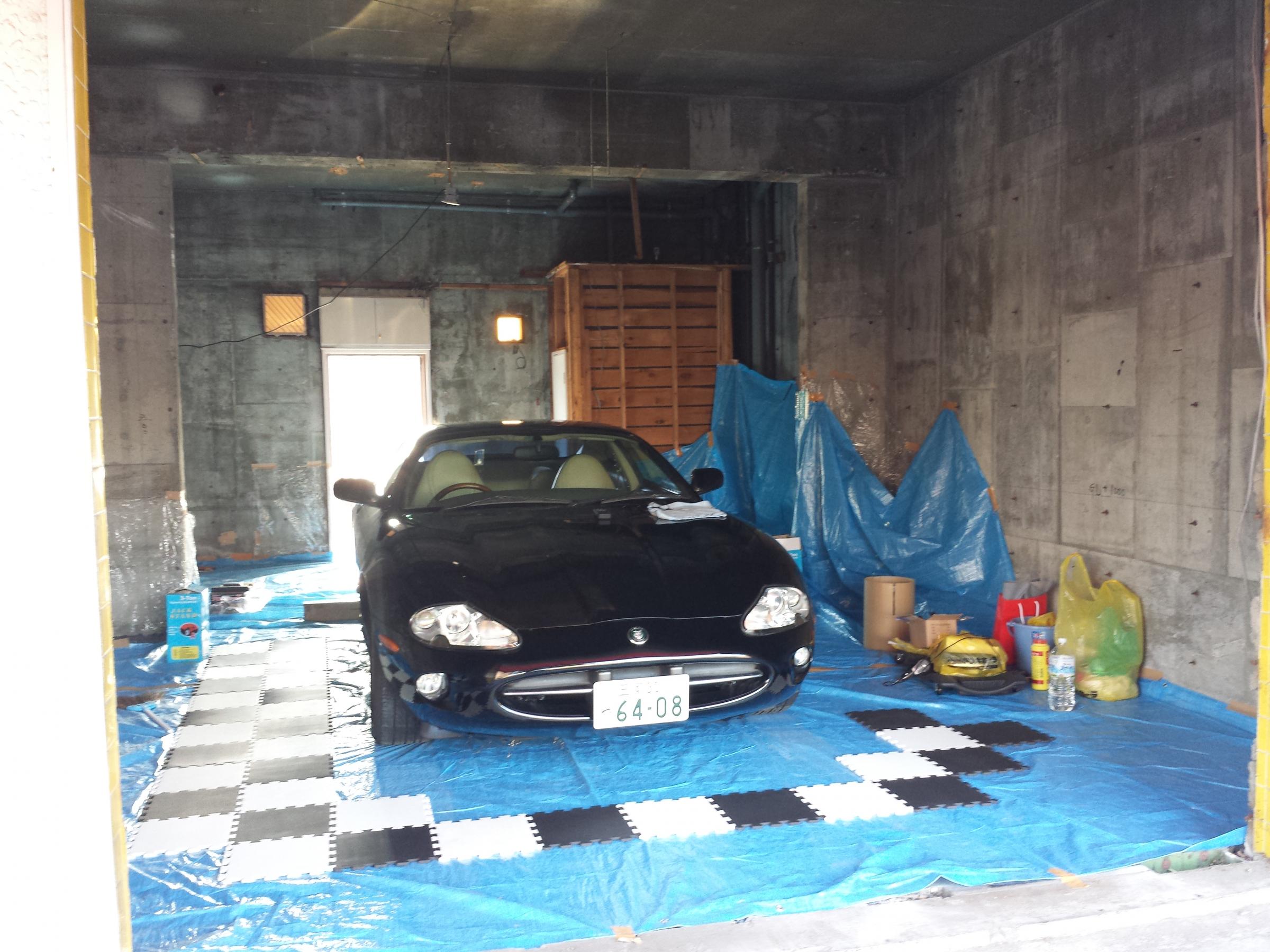

Hello All!
I've been planning alot for this project for the last 6months and I am finally getting my hands dirty!
Here are some background:
Got my 97 XK8 back in April as a donor car for this project. Since I got it, I've been driving it around for couple hundred km and not had a single problem..(well had few electronic probs but nothing major)
The reason why I'm doing this is cos I love this car and I've always wanted something unique. As for the V8 engine...It's a shame I will miss the thrilling roar sound but trust me, I am building a Jaguar and not a cat looking snail.
EV Spec:
Kostov 11" alpha Motor
Liquid Cooled Soliton 1 Controller
Custom Adaptor Plate
Custom Motor Mount
Toyota MRS EHPS
SP-LFP100AHA x100
0-100kmh(60mph):7Sec or less
Weight Ratio: Same as stock(hopefully)
Range/Charge: 100-150Km
Top Speed: +160km/h
Hp: 290
I will ask for may help but I am willing to take my time to learn!

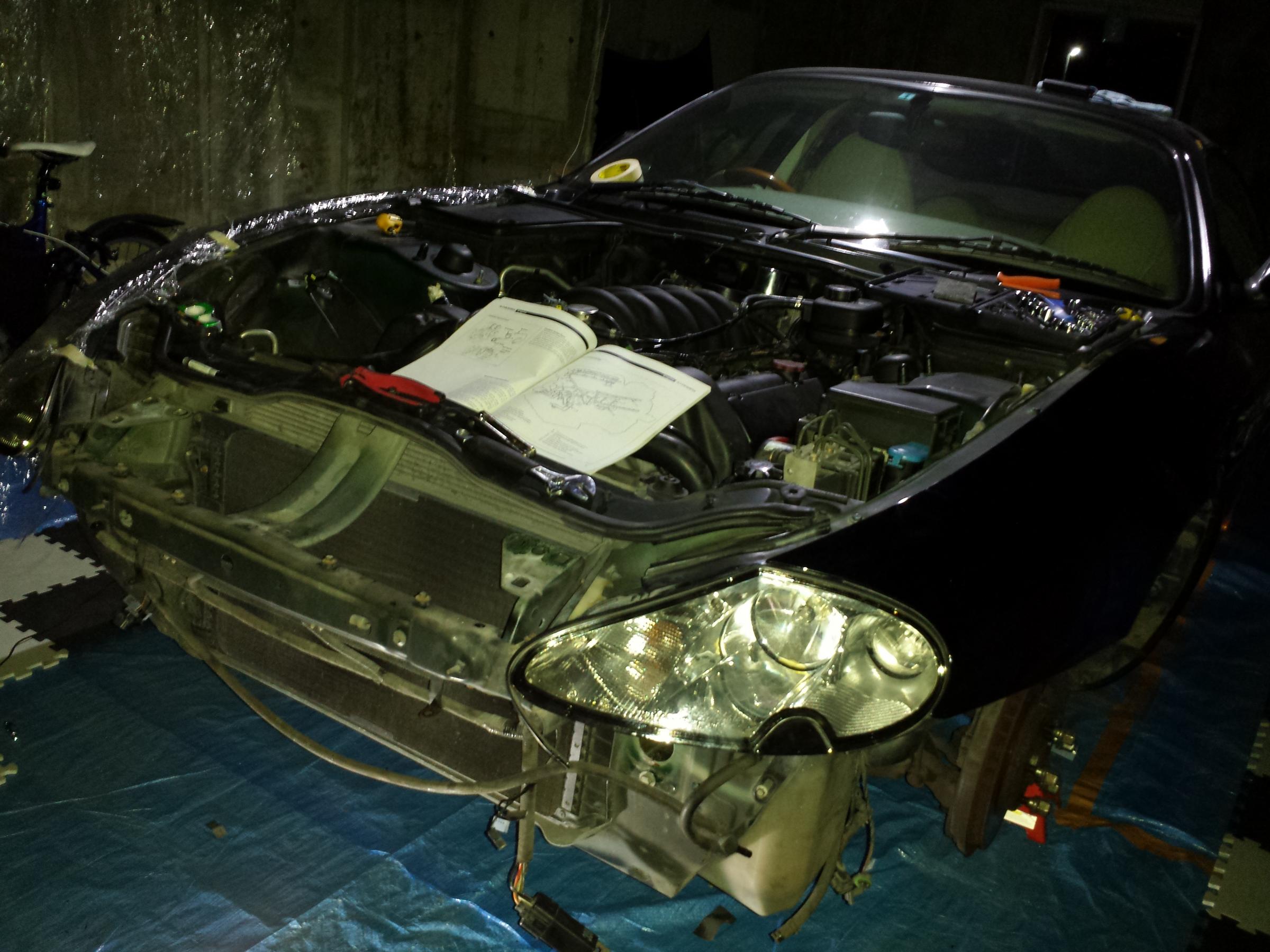

Here are where I am at the moment
Starting to remove the beast out of the beauty(removing the engine)
Rui

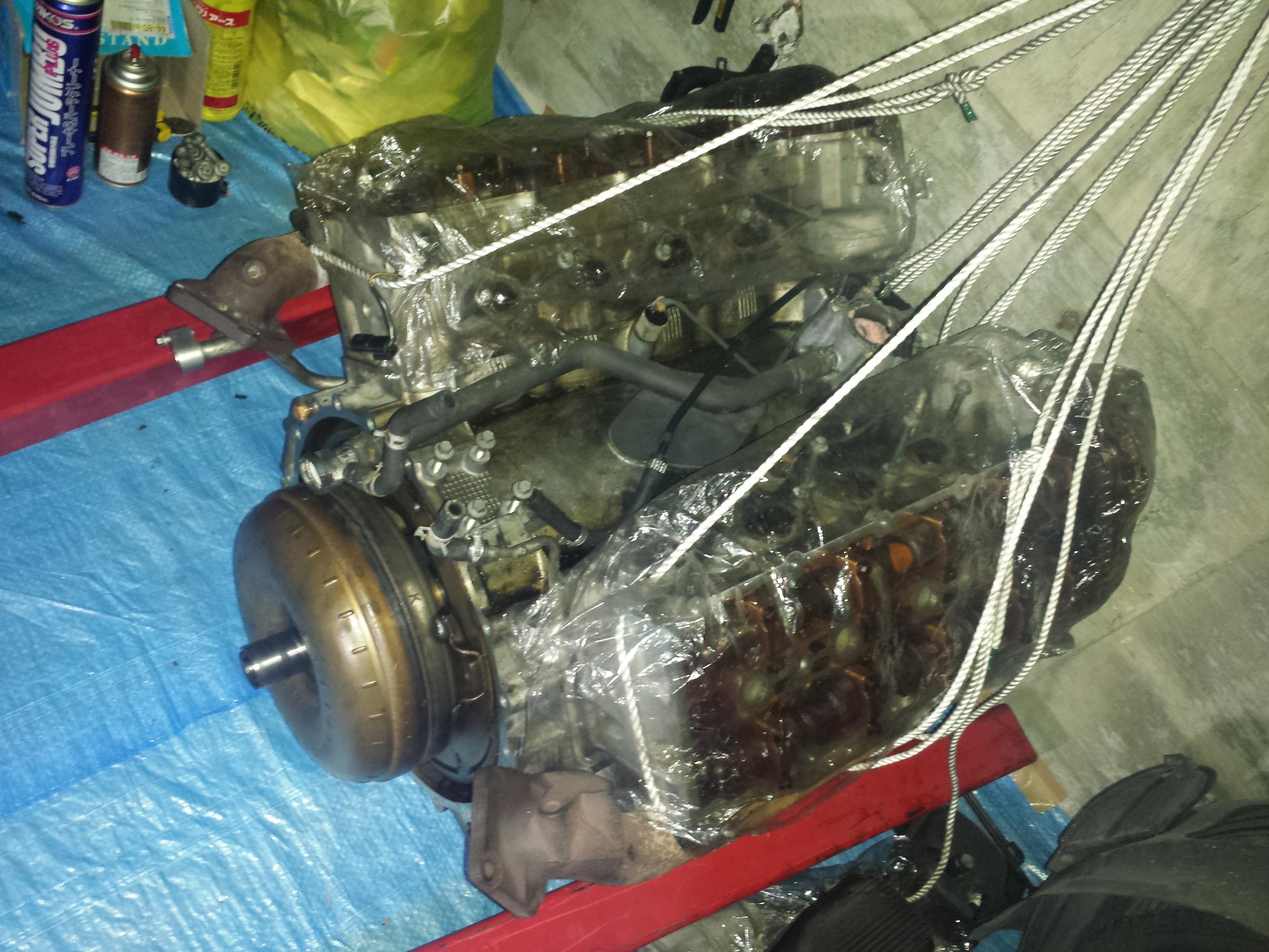

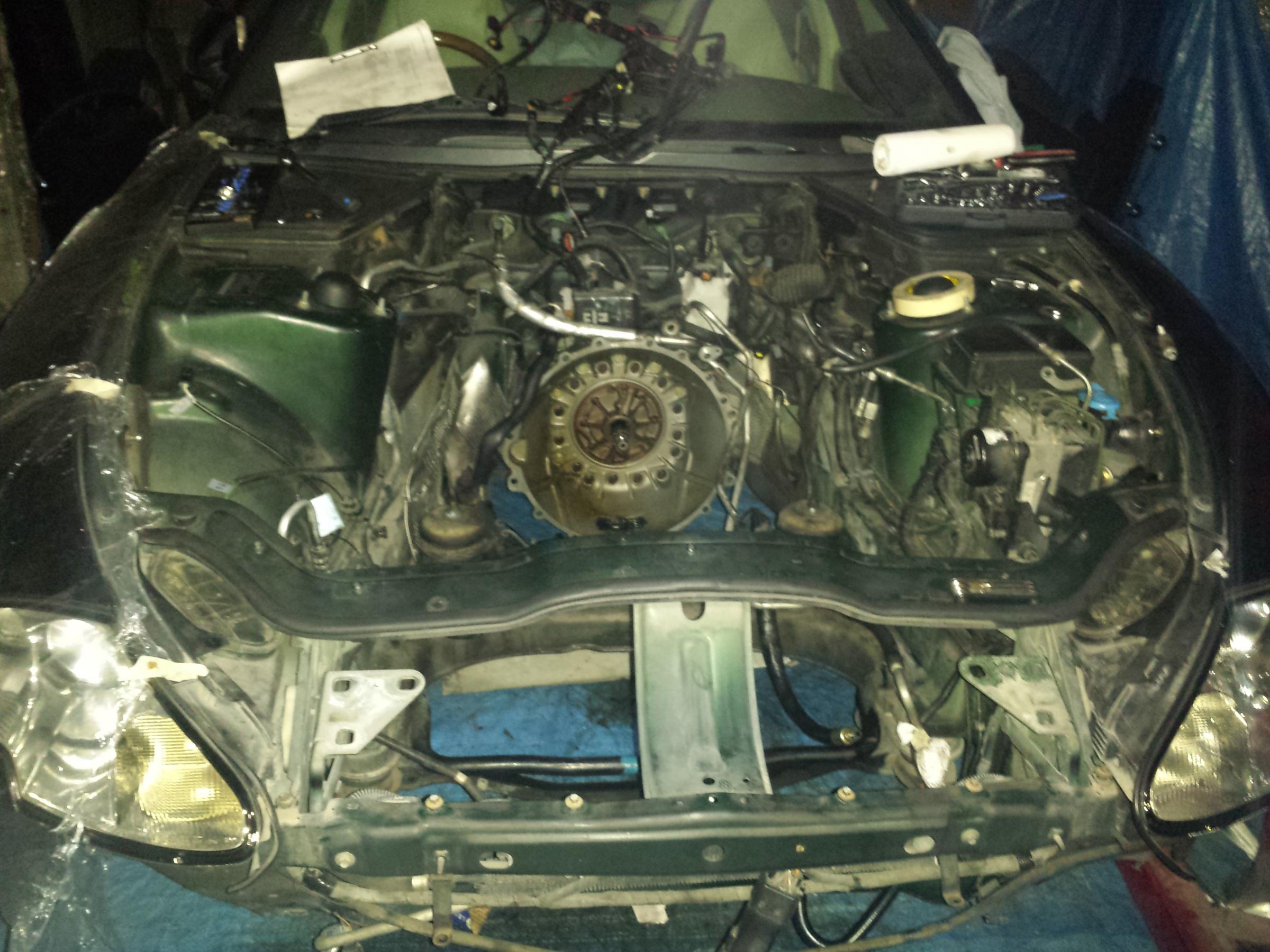

Hello forum! Its been a while since my last update so here we go!
I've been busy with work so couldn't get much done but ICE is out and ready to start the transplant of V8 to motor!
done:

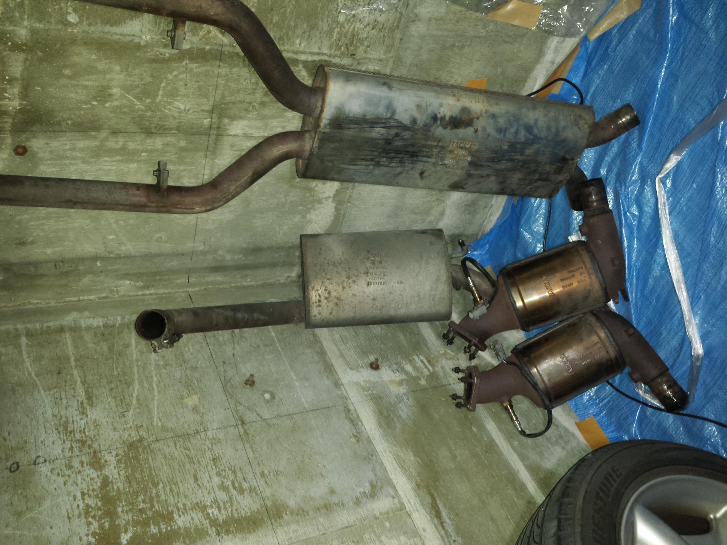

- Most of the Exhaust System is out ( one of the bolt isnt coming out...)
- Engine is out
- ordered EV parts (other than batteries)
To do:
- Remove fuel System
- Clean up
- decide where to place batteries
I'll be away for the xmas and new year but will keep this updated as soon as i can!

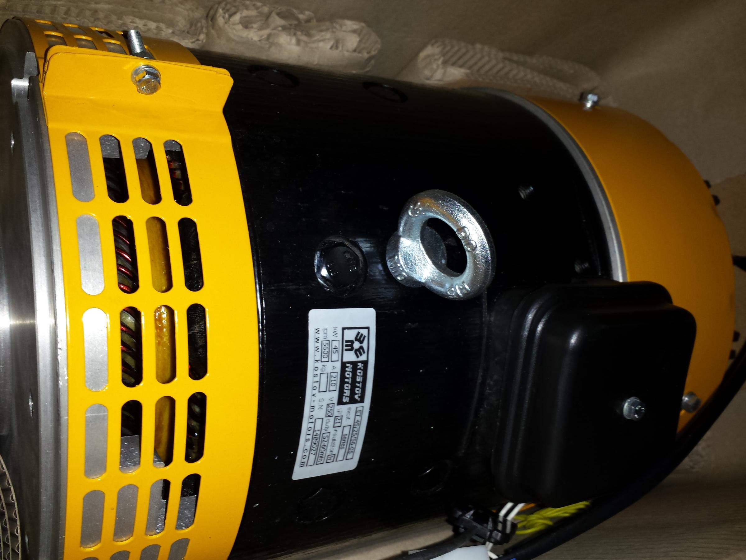

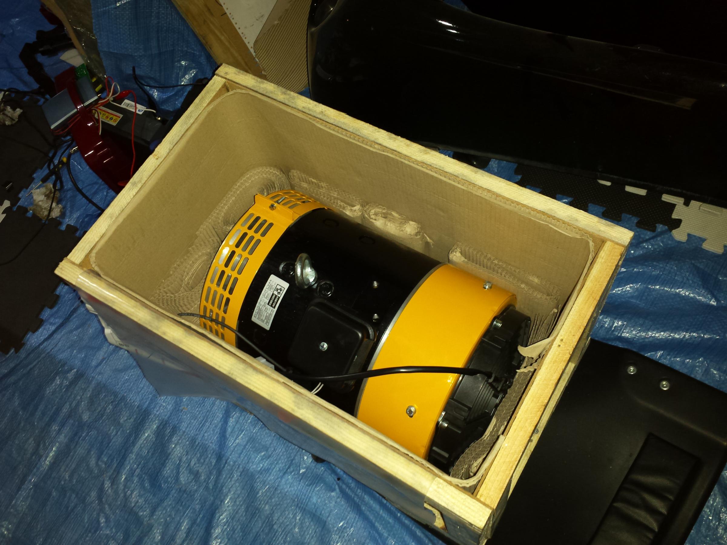

- Kostov 11" alpha has arrived
- Fuel tank is finally out!
- Batteries ordered and paid!
The motor spec is as follws;
Peak torque : 380Nm(280lb-ft)
Weight : 75kg
Power :137.5kw (184bhp)

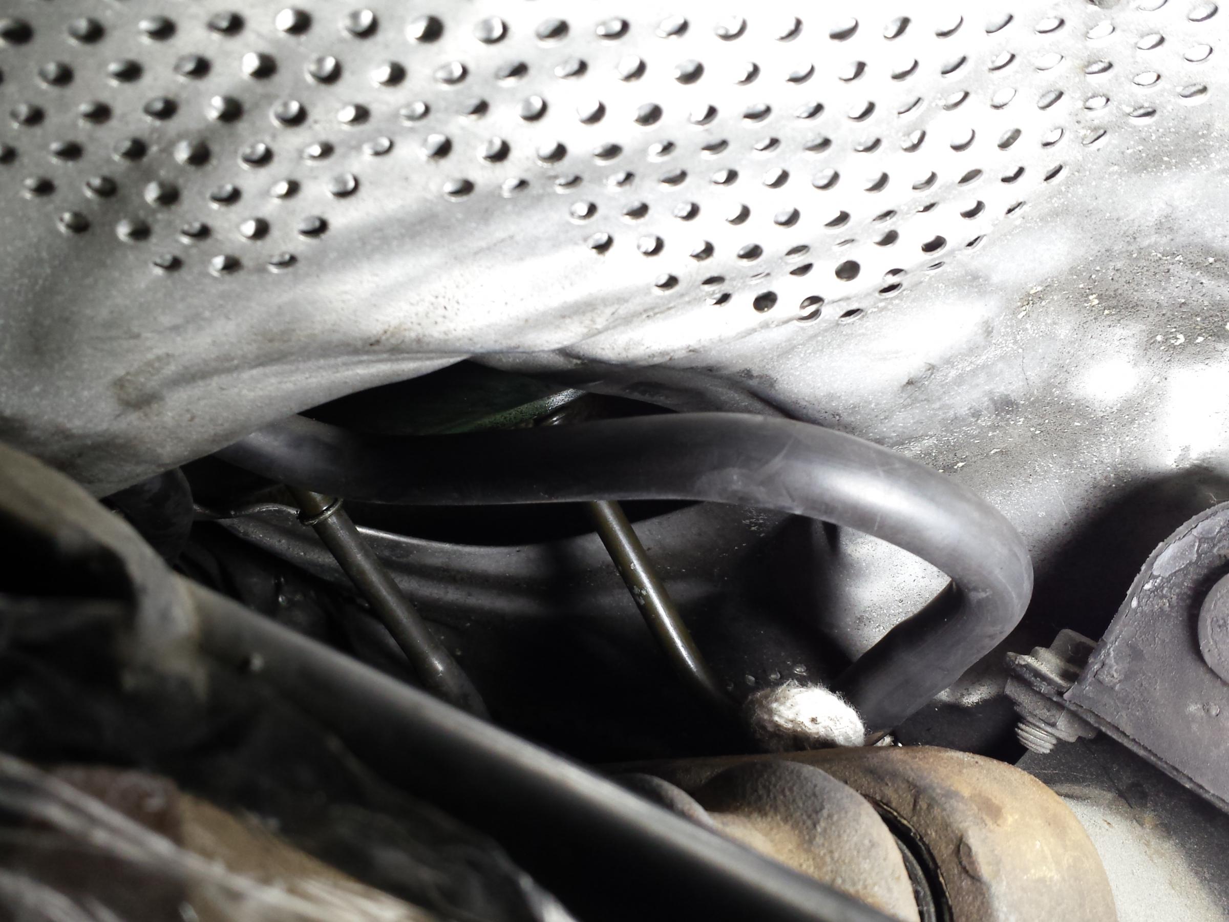

removing the fuel tank was probably the most stressful job so far!
the bloody fuel line just wont come out even with the tool! (the special tool is god damn small!)
Batteries are now being ordered and should arrive by April
