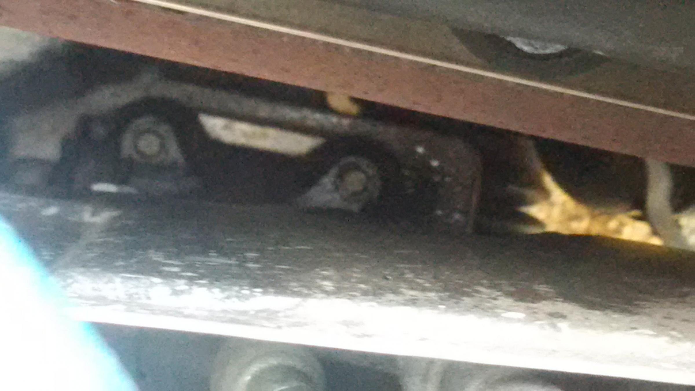

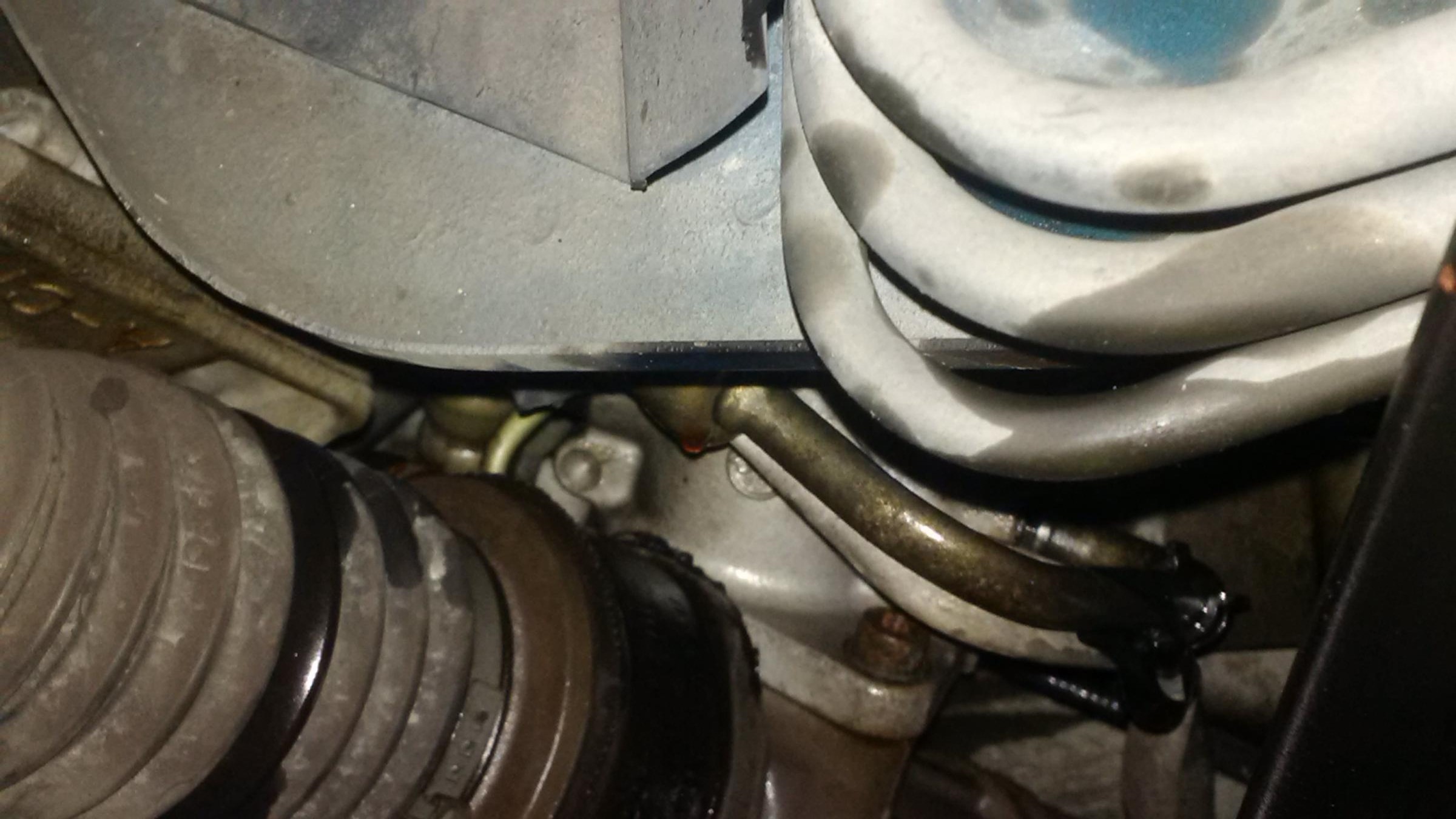

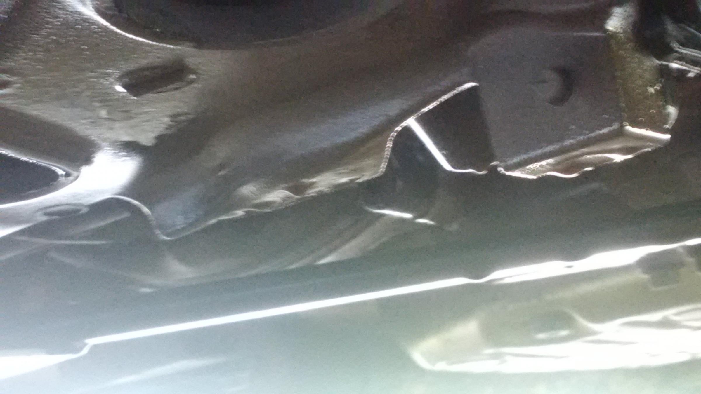

drove home from work and noticed a burning smell but all indications were fine and car ran sweet so thought it might be one of the other cars on the interstate. unfortunately got home and notice the odor had followed me home.
popped the bonnet and saw a small pool of liquid near the bottom of the engine compartment on the drivers side.
looked underneath and found she has sprung a leak. Now to get her on a lift to thoroughly figure out what needs repaired

You can see it is pink and if oily is probably a split on one of the PS hoses.

Agree with Race its pinky red liquid on the last 3 pics, so not from the engine. Most likely power steering problem, easily checked if fluid in tank. Good luck.

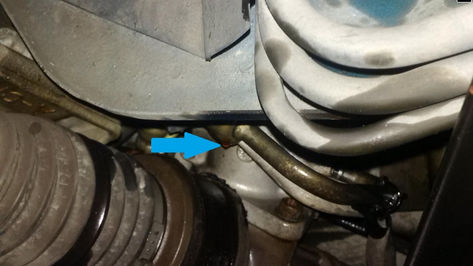

This looks like a drop of red P/S fluid about to fall:
I hope it's nothing serious.

my money is on the ps pressure line. had the same problem a few weeks ago. changed out the hose from the pump to the rack.
