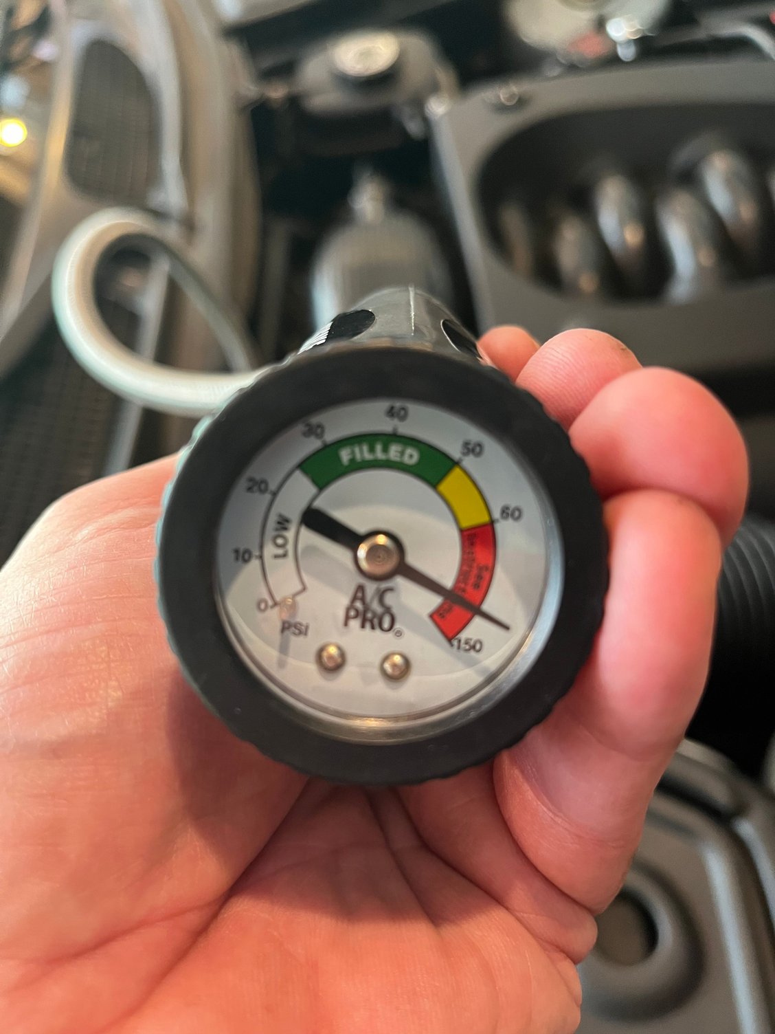

Bought a can of coolant with the gauge, and it jumped to red. Here’s a pic. Connected while the car was running and a/c on full with recirculating on.
So it looks like I’ve got a high pressure reading with no compressor running. Tempted to add coolant to see if the compressor kicks on, but everything tells me not to.
Thoughts?
Old Jun 20, 2025 | 07:04 PM
giandanielxk8's Avatar
Posts: 3,756
Likes: 1,622
From: Puerto Rico
I wouldn't add any. Something may end up bursting. Your compressor is not engaging. I'd rather figure out why it's not engaging instead of trying to brute force it.
First start by checking A/C fuses and relays. It may be as simple as a tripped fuse. If the fuses and relays are good, then use an multimeter to check if the compressor is receiving power. Since it's been sitting, it might be possible that some animal chewed through the wiring? If all the electrical stuff is good, I would suspect a compressor clutch failure. I doubt the system is overfilled if you haven't added any and it's been sitting, I don't think an under-filled system would give you a high reading on the gauge, would it?

Well said, Gian. I’ll investigate. Was truly hoping for you to say “go ahead, and some coolant”. lol.

Do not add refrigerant/coolant ! Your pressure reading is correct for a system without the compressor running. As has been said - you need to investigate the wiring/fuses/relay etc to find out why the compressor clutch is not engaging.
The resistance reading of the compressor clutch coil should be less than 10 ohms

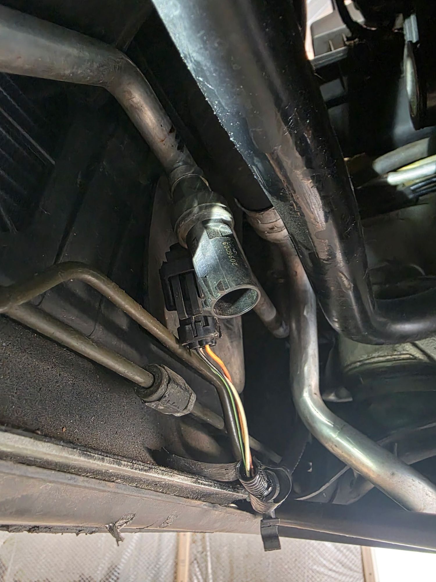

Default No A/C Solved. Duh!
Sometimes, the Jag Gods throw you an easy one.
Found this disconnection.
Reconnected and blasts cold air!
