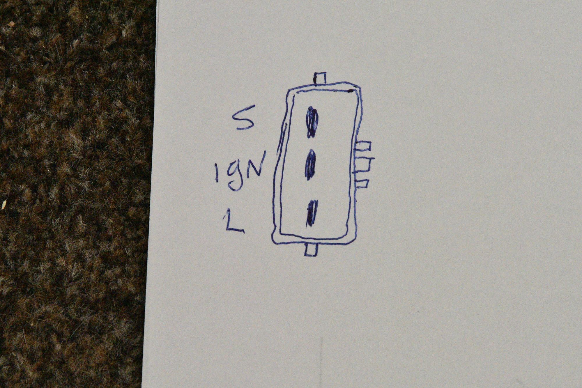

I recently changed the alternator for a new DENSO DAN 672 alternator . It has a small 3 pin connector like the original but only two are used .....bad boys FORD .
Now there are 3 types of alternator.
Computer-controlled which we dont have . A high initial voltage cutting back to 13.7 to save petrol.
Machine sensed alternator . this measures the battery voltage at the machine (the alternator). Now this is fine if the battery is near the alternator and has a nice thick copper cable between battery and alternator.
Battery sensed alternator where a wire ( marked S for Sense) runs from the alternator to the battery positive having no other function but to tell the alternator what the battery voltage is. Now if this wire breaks the alternator reverts to machine sensed BUT AT A LOWER VOLTAGE. not good.
So you got it ford left the sense wire out and uses aluminium cables for economy and put the battery in the trunk.
Fortunatly this can easily be reversed.. the plug is available..chop off the old one and solder on the new one running a thin lead to the battery positive with a fuse at the battery end.
The three are S I L for sense ignition and lamp. Easiest way to fit is the match the position of the original wire to the new plug ..the one left over is the sense. fuse at the battery end .

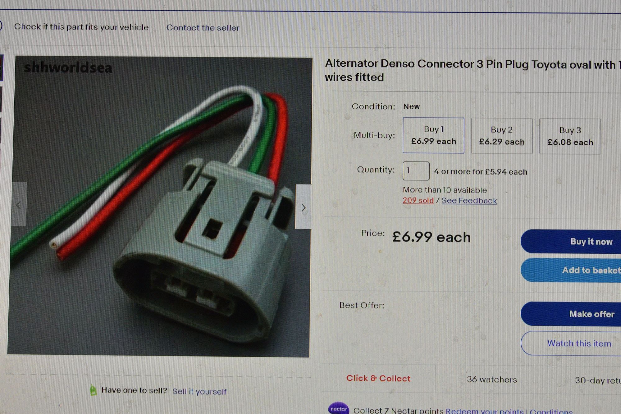

if you go to ebay in the US and put in Denso 3 pin alternator plug you will get lots on offer ..some from china some US for about $12. Or you can Google the same and get suppliers.
the one identical to my photo comes from California_alternator_starter ..liiks like its a common item particularly when upgrading the alternator on US Toyota Trucks
