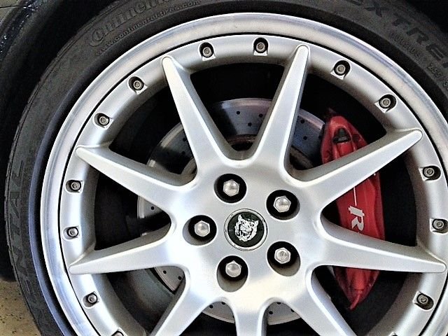

Exclamation For those of you that like to ST.......OP!
I just walked out to the Garage and took this Photo! No special lights just an iPhone!
When I had the 2000 XKR it had the plain old Jaguar Brake Rotors and Pads...….They need help! So, I found FrozenRotors.com and called them to help me....I came away with a Beautiful set of Drilled & Slotted Frozen Rotors and new Hawk Pads.....Cost a little but MAN!!! I had some BRAKES! As I have progressed through the years to newer and different XKR's, the first thing I did was to upgrade the Brakes...The 2003 had Drilled Brembo brakes, so I sent them to Frozen Rotors to be processed and they sent them back with Hawk Pads...….Then, I got the 2005 XKR and did the same thing over 50,000 miles ago...…! Today, after reading this Thread.....I notice several guys wanting to know about Ceramic Pads and I wonder why? I couldn't ask for a better Brake Pad than my Hawks.....They Work!!! and the Frozen Rotors show very little wear over these last 50,000 Miles! I figure I've got a minimum of another 50,000 before I even have to start thinking about my Brakes...My driving is in traffic daily, stop and go, stop and go! I'm not easy on Brakes....You Guy's do what you want but I going stay here....
