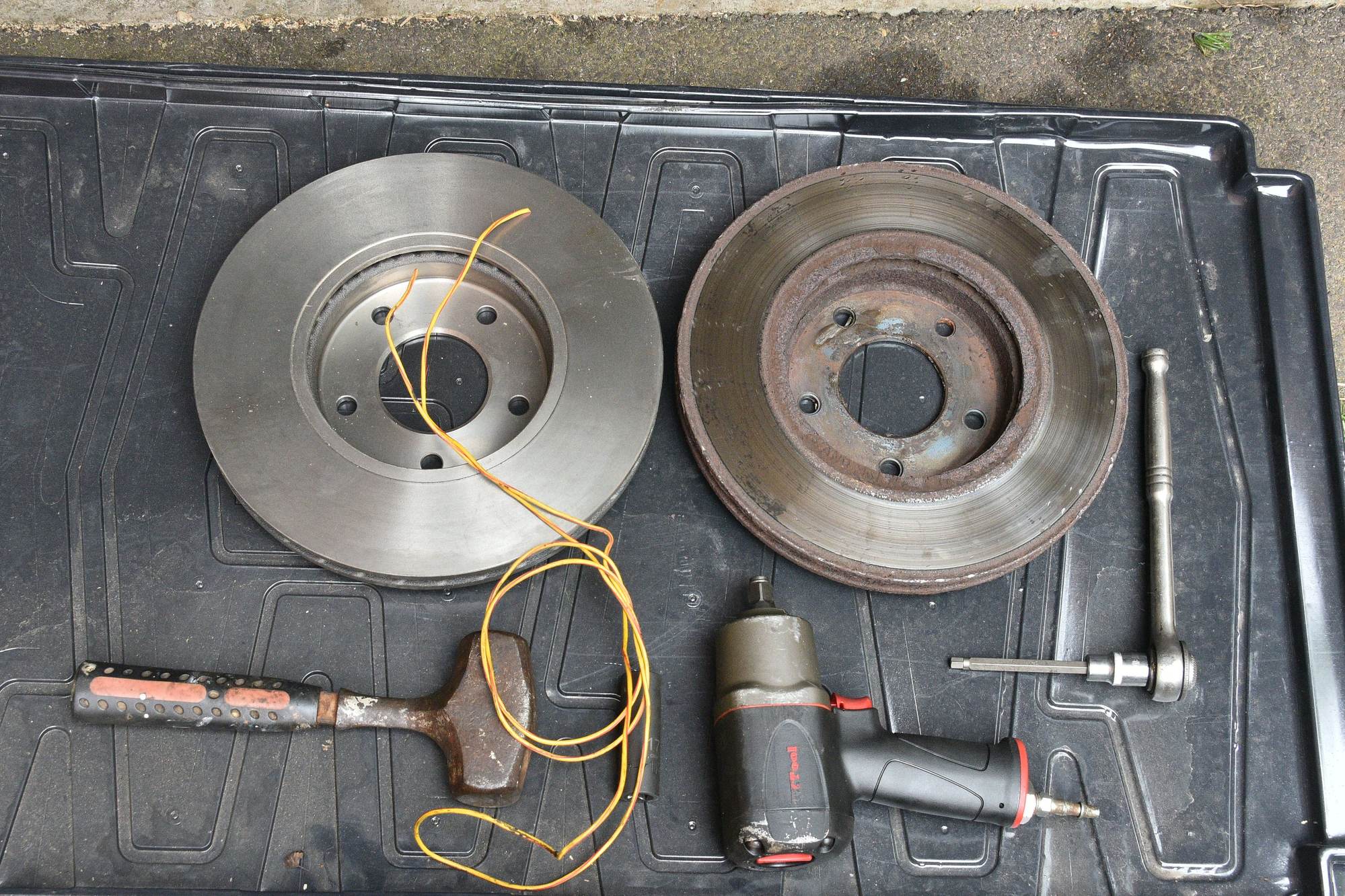

I managed to get a set of NOS 305mm discs for 25 ($30) and some approved pads from Germany for 10 ( $12) Crazy prices but thats life... So hear we go
Remove wheel.
7 mm hex to remove the sliding pins holding the brake calliper.
Hang calliper on some wire out the way.
17mm Spanner and 4 lb block hammer for the holding bracket bolts .. TOTAL FAIL.
Rattle gun air operated on same bolts ...TOTAL FAIL
Heated the heads of bolts with small propane flame and applied rattle gun SUCCESS
Spray the centre of the hub with WD40 to soften the gunge on the spiggot.
Wack the disc from the inside with the block hammer and after a few dozen blows it will start to move and therefore take it off.
Clean the centre around the spigot area with emery cloth or you won't get the new one on.
Clean the rear of the disc with thinners etc to remove the anti-rust coating.
Fit the disc and push it fully home with a long 17mm socket over each wheel bolt and the block hammer.
Fit the calliper holding bracket.
Push the piston back with a G clamp.
Clean the outer face of the disc with thinners etc
Fit pads and calliper and retaining sliding bolts.
Fit the wheel
Do the other one ...about 1 hr for each side.
Old pads riding on the rust ridges..basic kit shown above

Good job. This is to add to your great description. Just another way:
Caliper bolts: at least on my 98 XK8, You can turn the wheel far enough so a line from the bolts to area outside the car is clear. Turn the wheel. Put your ratchet on the bolt and slip a 4 or 5 ft pipe over the handle for leverage.

Rattle gun rules ..see the photo..only paid 36 ($42) inc 10 hardened sockets from 10-19mm ..Brilliant tool.
