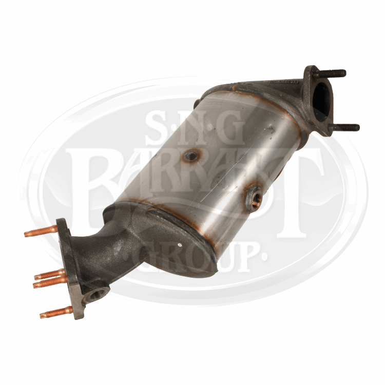

On the Jaguar drawings it looks like it's just a stud between the exhaust section and the cataverter (nice word). SNG Barratt UK | EXHAUST PIPE FRONT-PETROL Assembly I think the only problem would be the mount which apparently is different for the 4.2 compared o the 4.0. No idea why Jaguar changed this stuff for no apparent reason. Anyway it's not like Ihave much choice in the matter, I need new cvataverters and the only affordable ones are the ones I linked. If the mount doesn't work it might still be OK or I could try and rig up a mount to make it work perhaps. This is what the 4.2 cat looks like 98fa192f-e7b3-4ace-b184-8146782b6886.png (750×750) The BM ones are stainless steel as well so they shouldn't rust like the OEM Jaguar parts. I am surprised no one has had to replace their cats for the 4.2 engine yet on the forum.

The inside of my cats are fine they still pass emmisions in the UK. The problem is that I have two holes on the bottom of the cat from rust from salty roads. The metal is too thin now to repair.

If you take the cats off and go to a welder they will be able to fix them for you. I welded mine up lying on my back under the car.
