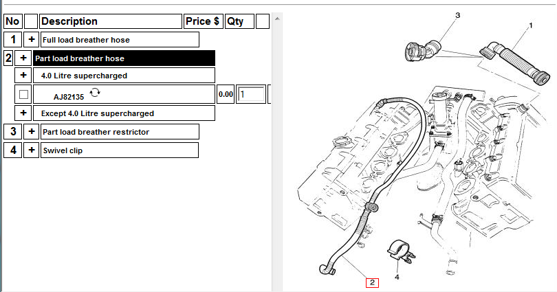

P0171 is going to happen when you have cracks in either of the cheap-*** plastic tubes that disintegrate that run to your either full load breather hose or part-load breather hose (the most common places for vac leaks as they're directly on the intake manifold, and are made out of plastic best suitable for prizes found in gumball machines). On the XKR, as I found out just yesterday, the part-load breather hose on the left hand side runs under the supercharger. If it breaks under the supercharger, it is likely going to require pulling the supercharger to replace. Mine broke right as it exits the front under the supercharger, and I'm going to attempt to hamfistedly bodge expertly craft a repair using either a rubberized vac elbow or a custom vac line insert and extension. I'll record my project as I go when the parts arrive, likely tomorrow.
EDIT: Forgot to mention- the part-load breather restrictor can get clogged. There is a TSB on this which addresses how to clean, using a 2mm or so drill bit that, if dropped into the cam cover while cleaning, will require the cam cover to come off to retrieve so tread exceedingly carefully. If that port is clogged, but your vac lines are still magically intact, you may also get a P0171. The smoke test is a DEFINITIVE way to isolate vac leaks though- and if you don't see obvious problems with your breather tubes, that would be your literal smoking gun.
Unfortunately, I suspect you'll find that, if one part of that infernal hose broke, the remainder will be very brittle, too. Mine broke near the valve cover connector. While trying to rig up a patch with electrical tape a big chunk pretty much disintegrated. Of course it's a Jag-only part, and of course it cost 3x what an equivalent cheap-o plastic hose should cost.
Yes. The straight-run portion is what remains of mine and is thankfully still airtight. If my re-engineering doesn't work I'll likely cap off that line, and tee it off at the accessible portion near the rear of the engine, and run it around the outside with silicone vac line, reusing the connector at the cam cover. If it didn't connect to something else UNDER the supercharger I'd have already rerouted.

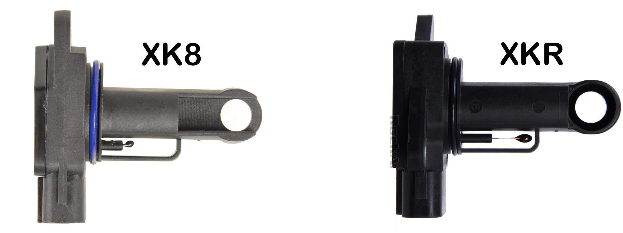

Occam's Razor dictates that I ask if you changed the XKR with the appropriate MAF sensor, and did NOT use an XK8 MAF sensor. They will physically interchange I believe, but they are not electronically the same, and will throw off mixture... unfortunately the XKR MAF is more expensive and harder to source.
EDIT: added illustration. Same same, but different:
