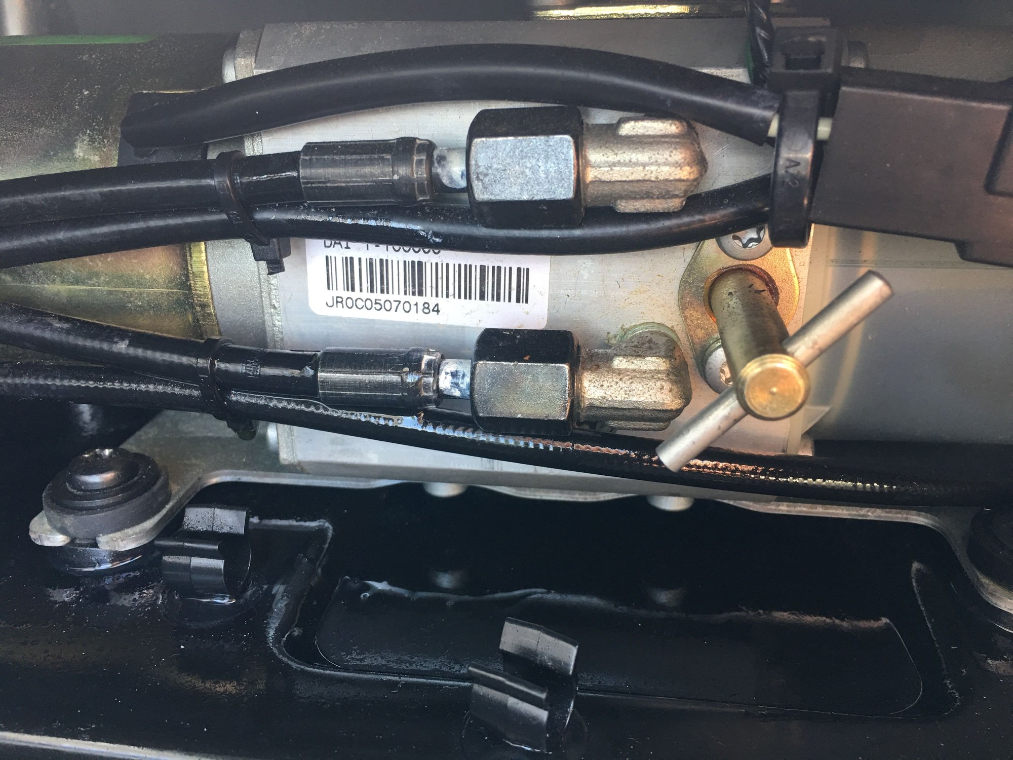

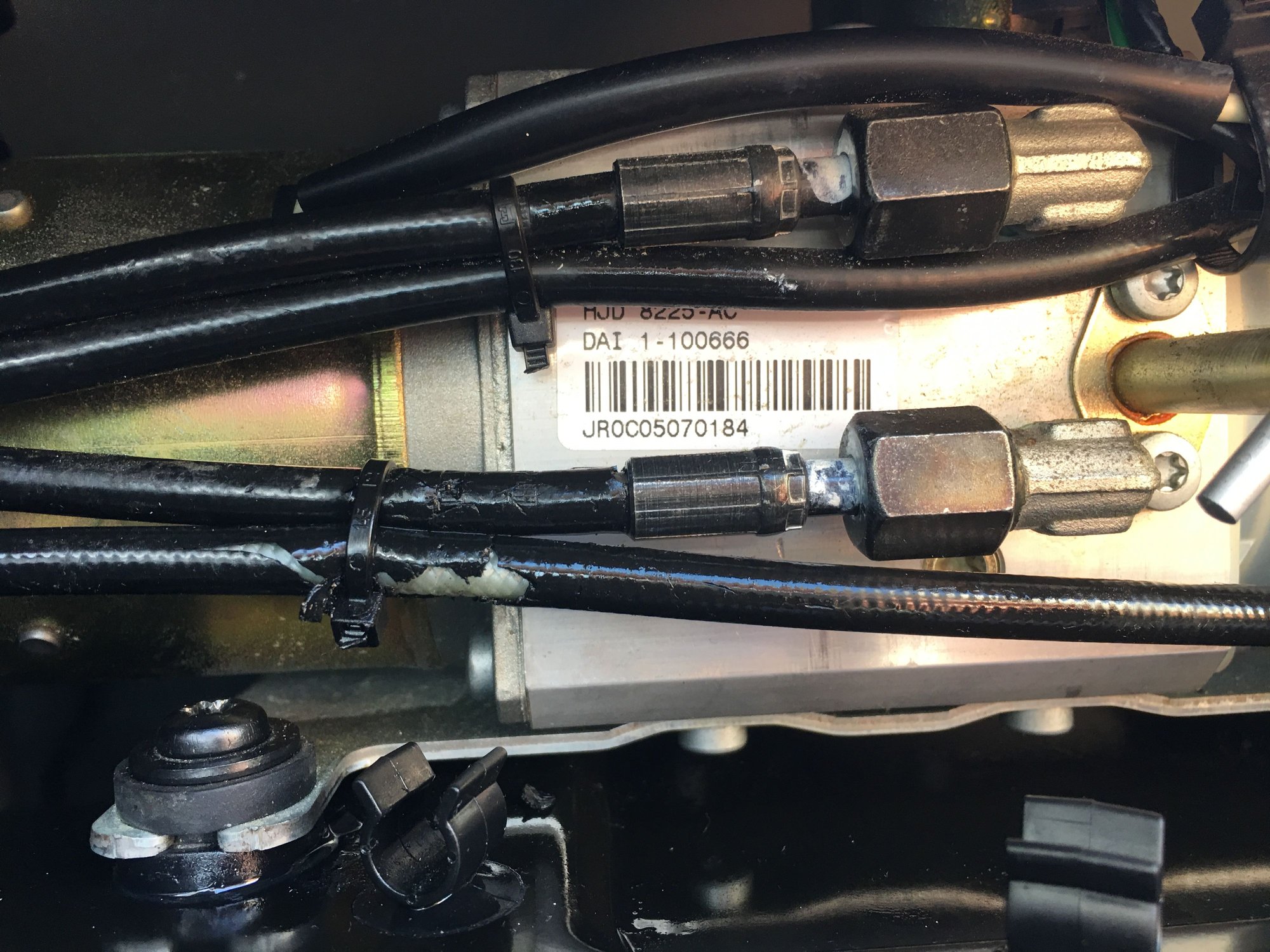

When I bought my XK8 my first concern was the green shower. I checked the hoses à the hydraulic pomp and I was able the see the degradation of the hoses. So the next step was to replace all hoses and replaced cylinders with rebuild ones from Top Hydraulic. My only concern was a defective cylinders and I had to buy a OEM from Jaguar because warranty was not accepted by Top Hydrolic.
i have picture of the degradation of the hoses that show that a green shower was coming soon. After opening the top latch console, we found similar degradation of the top latch hoses.
