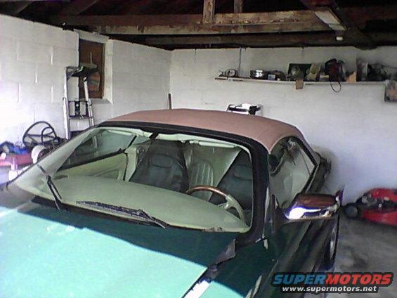

Took my top to a automotive interior shop, as the sun has faded its oem color and its ugly.
The technician has been doing tops for a while and suggested, I soft scrub the top with very hot water and simple green , then rinse 5 times, then allow to dry for several days to remove all dirts and mildew.
After this, he suggested 6 cans of camel color Camel Upholstery Spray Paint (SP413) - $11.50 : Colors for Upholstery & Auto Interiors
This is actually a dye,it has UV protection built into it and designed to withstand harsh weather elements for many years to come.
Enough talk, the results speak for themselves, this is just 2 light coats,it looks scary with the first coat, but after it dries your good, very absorbent .and strong,waterproof and uv protection.THE TRICK IS TO SHAKE THE CAN VERY WELL AND WORK VERY FAST, MASK OFF, THIS STUFF FLIES EVERYWHERE, BUT COMES OFF THE PAINT EASILY WITH BLACK MAGIC TIRE SHINE AND A SPONGE, THEN WASH THE CAR LOL TO GET THE BLACK MAGIC OFF.

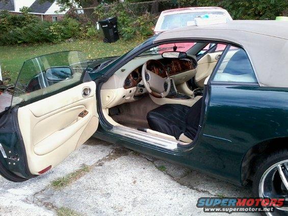

its been 24 hours and the job looks NICE! Car never looked so much better.
This stuff is tuff , and I'm loving the look!

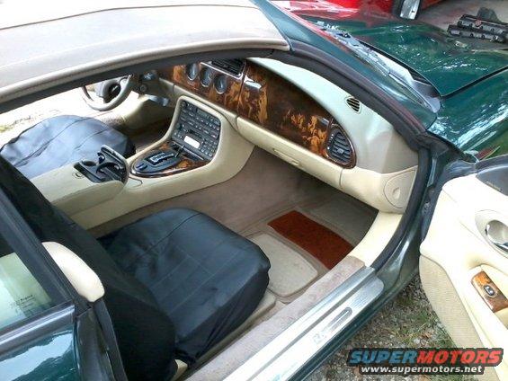

Chek out how good it works, when you clean the panels and carpet, let dry then use the product, again, i used simple green, and took my time masking off that areas, and shacking the cans for 5 mins each with duplicolor.
Attached Thumbnails Convertible top and interior professional color restoration-0_1-2-.jpg   Convertible top and interior professional color restoration-1_1.jpg

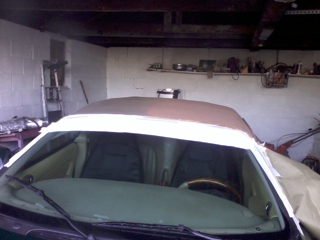

Convertible top restored, works fine, been up and down 39 times lol.this stuff is awesome!!works EASIER spraying in a can or bowl, then brushing on a clean prepped, dry top,THAT WAY IF YOUR LAZY, YOU DON'T HAVE TO MASK THE CAR OFF. here is the pic.
LOOKS AWESOME!!!!!!!!!!!!!!!!!!!!!!!!!!!!!! COMPLIMENTS EVERY TIME I DRIVE , EXCUSE THE GARAGE, NO LIGHT AND I LIVE IN THE RUINS.

Thanks, the hardest part was wearing a thick glove, using very hot water and simple green to scrub all the dirt, mold and mildew off the top.It also removes the water repellant as well.
All you have to do from there is LET THE TOP DRY FOR A WEEK mask off the rear window only,simply spray the contents in a bowl that you never plan to eat with agin, and use a SMALL paint brush to apply several coatingS, allowing EACH COAT TO DRY 24 HOURS.
DO NOT GO BY HOW THINGS LOOK WHEN THE COMPOUND HAS NOT DRIED IN A DAY, YOULL SIMPLY BE WASTING IT.
This agent absorbs INSTANTLY AND HAS ITS OWN OUTDOOR POWERFUL WATERPROOFED AGENT.
The interior took more time, due to using garbage bags and duck tape, however, I used simple green and very hot water to clean the door panels, carpet and dash.The applied DUPLICOLOR INTERIOR PAINT TO THE PANELS ONLY.
The carpet was vacuumed after scrubbing only-like a shampoo lol NO DYE OR PAINT ON CARPET.
