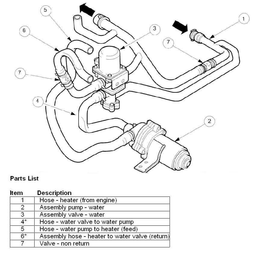

So number 1 on the diagram? XK8 has 105k miles so thinking I'll replace all while I'm there. Also will do short thermostat housing to engine hose becase mine looks like bulging. Found it at autohausAZ. They call it a "spider" hose. I pulled the intake on my XJ8 to change to the metal thermostat tower so been there before, Will also order new intake gaskets and injector o-rings.

Not sure of your VIN but your valley hoses are probably 1 and 2 in this diagram:
Here's the link to the diagram and parts list at parts.jaguarlandroverclassic.com:
https://parts.jaguarlandroverclassic...uNzUyNTY3MzY2/
You'll also want to replace a number of other parts, such as the plastic 3-way connector (Part 9 in the diagram), the intake manifold gaskets, throttle body gasket, and any other seal or hose you have to disturb. Lots of DIY info in the forums.
