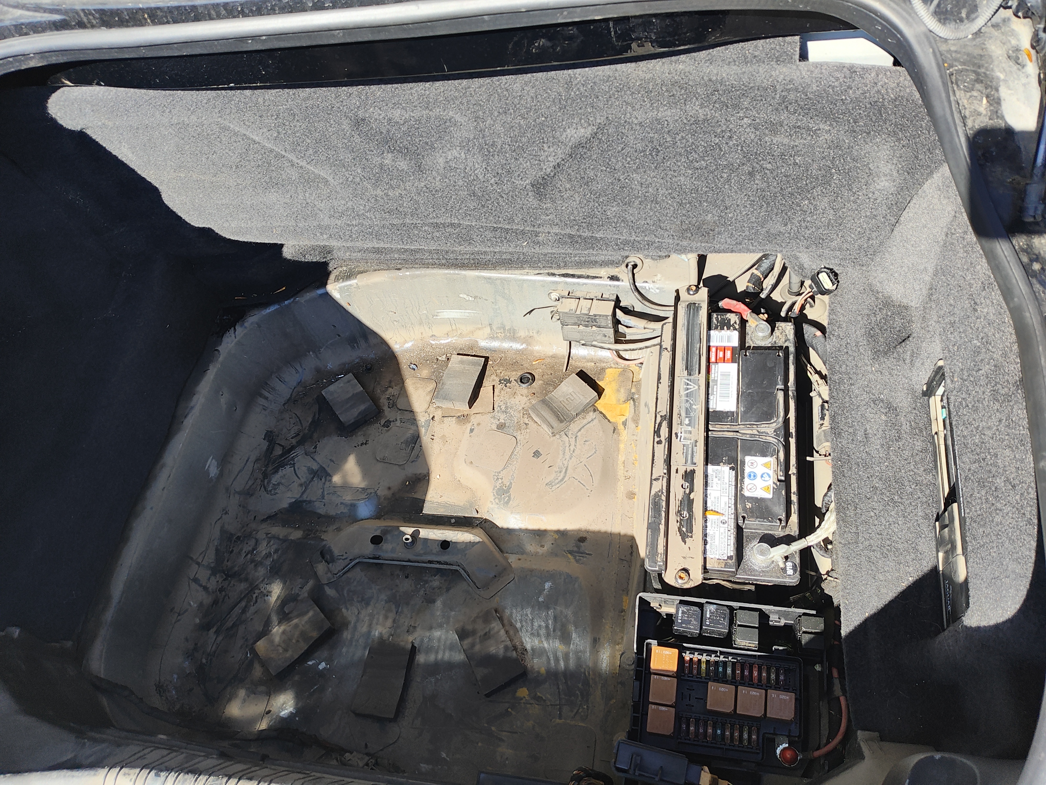

Here's a picture of how the trunk looked after I pulled all of the carpet up.
Attached Thumbnails Got my convertible top pump to fire to life!-img_20250503_102227483_hdr.jpg
